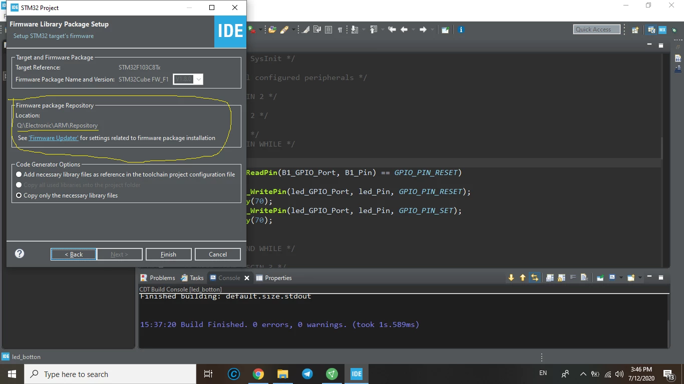

Hello community, I have a problem with new project creation, whenever I want to create a new project I come across this error: create minimal project failure: cannot read template source. reason: internal error
i know the problem which is having a space in my user folder name which i don't wanna change because it might mess my registry files.
so i'd like change the repository location to another place if it's possible.
thank you for having me.

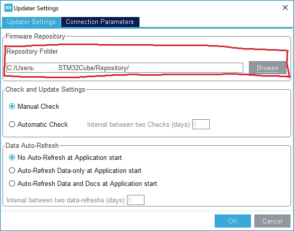

In STM32CubeMX, you can navigate to Help -> Updater Settings to change the repository directory. I don't know if this will carry over to STM32CubeIDE, but it may.

I changed that but it did't help
i find a way to change "Firmware package repository" in CubeIDE when creating project and still nothing
I'm getting mad, it's been 4 days i'm dealing with this thing, i don't know what to do...

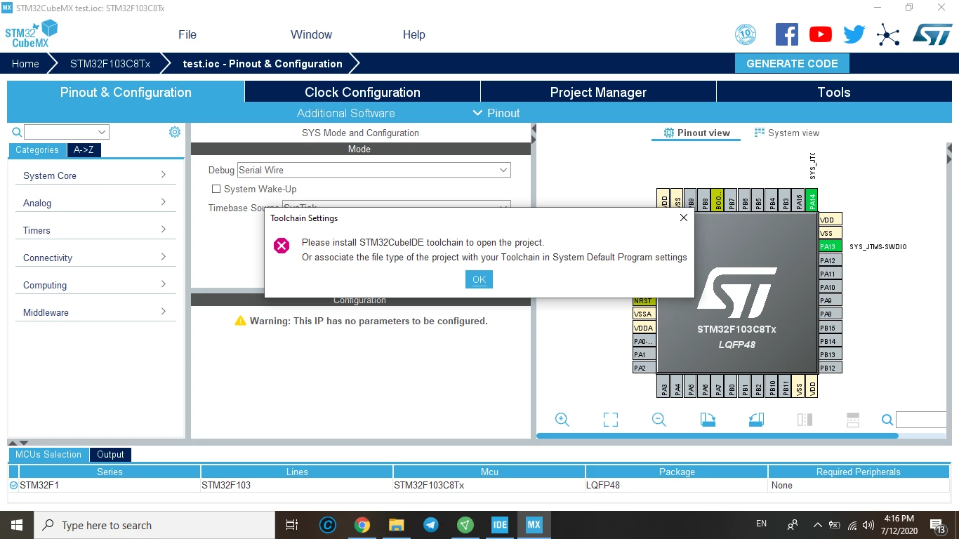

another thing: when i'm trying to create the project from standalone CubeMX, this error pops up, thank you very much!
and I have installed the CubeIDE!
i'm not sure what i'm doing wrong...
