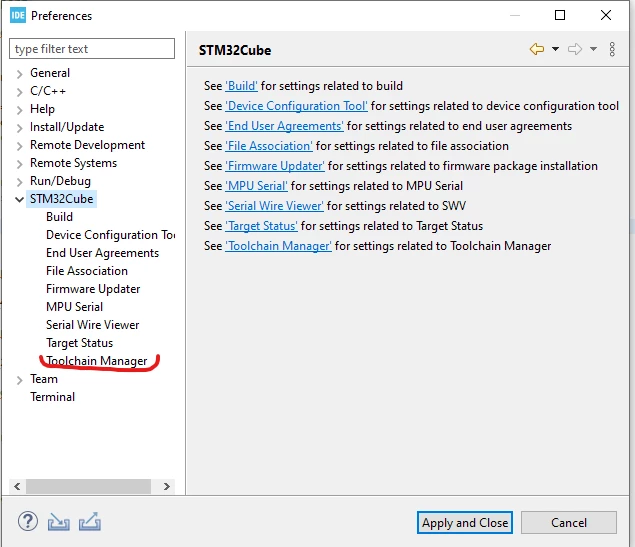

How to change the compiler version on CubeIde
  1. If I want CubeIde to use a specific gnu arm version which is on my local system, should I just setup the build variable "gnu_arm_embedded_compiler_path" ? Is that enough?
  2. If I wish to check the current version that cube ide is using, how do I do that?
Sorry, maybe basic questions but would be of help. Thanks!
Pavel A.
Pavel A.Best answer
Apr 21, 2021 3:22 PM UTC
Just use the toolchain manager. No need to tweak PATH; CubeIDE will ensure that the chosen toolchain is called.
