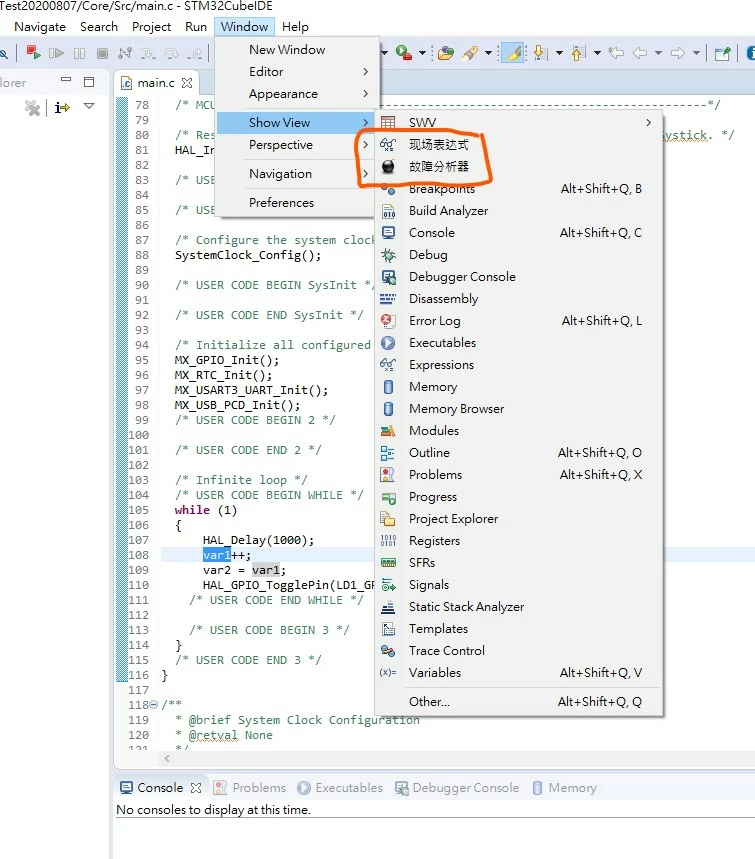

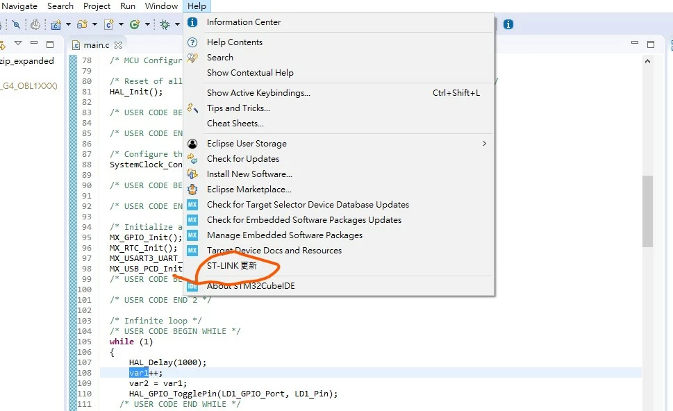

Hello all,
I just installed cubeIDE for a moment.
However, some text is displayed in Chinese such as follow,
Does anyone know how to change it to english text?

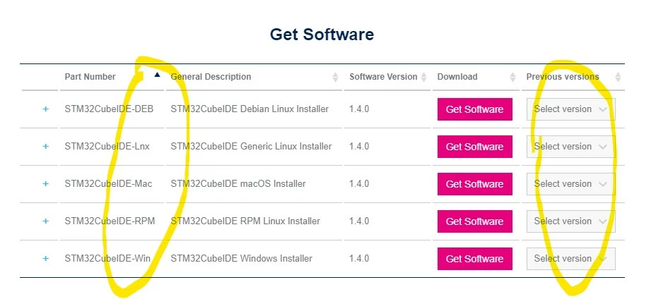

yang2Author
August 17, 2020
No, there are no selection for english version.
It just have to choice your OS and software version.

I have tried for fresh new ide of 1.4.0, nothing issue with that , download again and try once . latest edition
