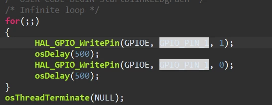

I am trying to figure out how I can change the grey highlighting color to make the dark theme usable. I could not find it in the settings yet.
Have attached a picture as reference.

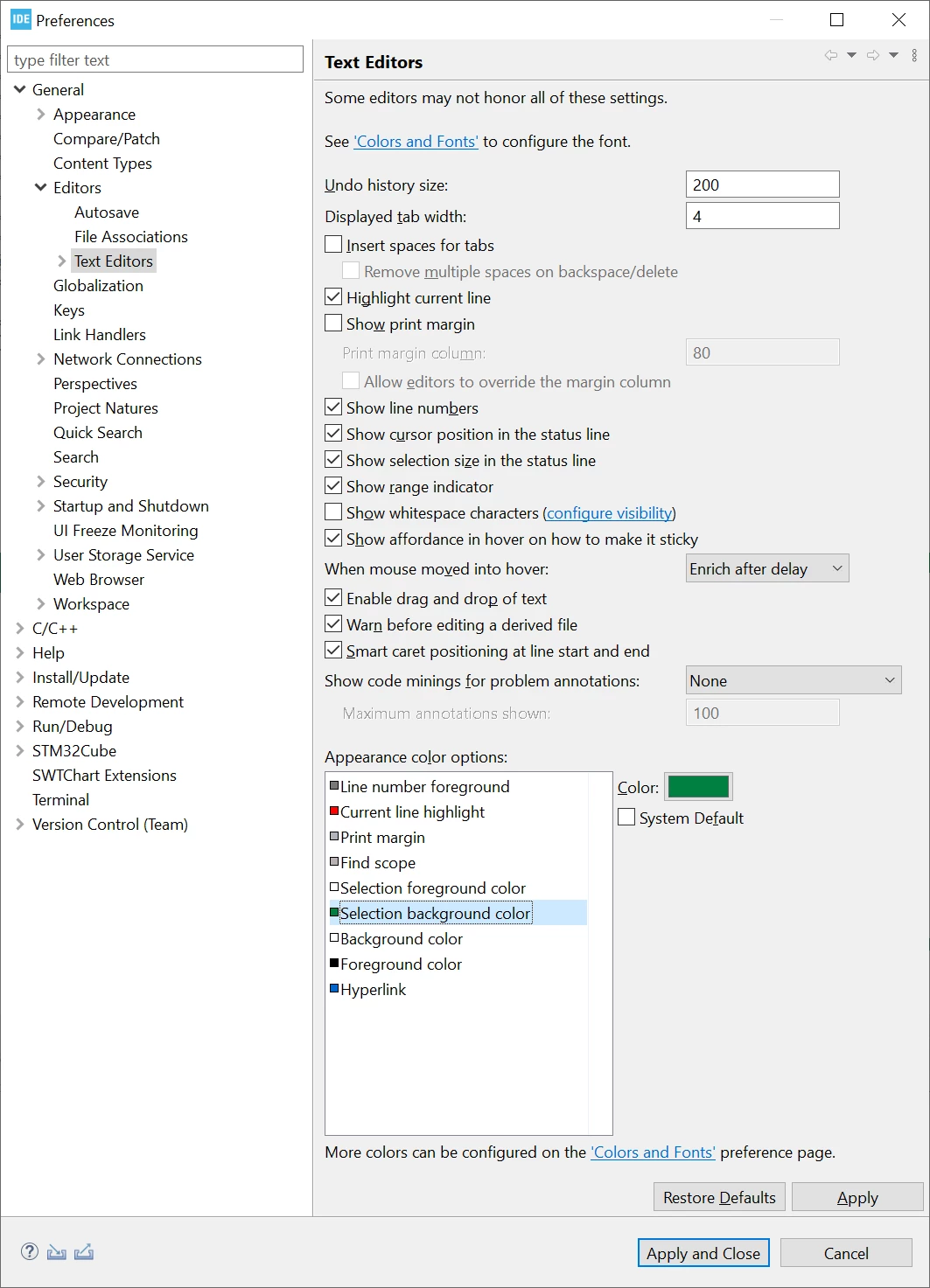

Hello there,
It should be in "Window -> Preferences -> Editors -> Text Editors -> Selection Background color".
MBabu.3
MBabu.3Author
Hello Markus,
thank you so much for your support.
I tried to change all colors in this setting tab, but unfortunately it had no effect in changing the grey color of the highlighting bar.
Have changed colors in the "Colors and Fonts" tab, but unfortunately so far without the desired effect.
