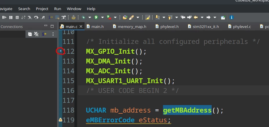

How to change breakpont icon size?
I'm really uncomfortable keeping track of such small icons, which are also almost the same color as the background.
0693W00000bhKXKQA2.pngI tried to find the brkp_obj.png file in the /opt/st/ directory (as suggested on stackoverflow), but did not find anything similar.
Is it possible to change the size and color of this icon?

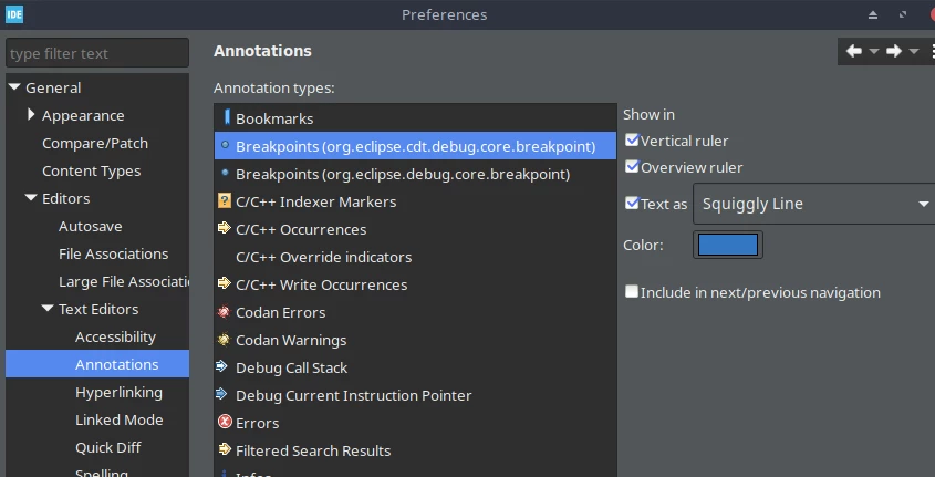

right....i dont know, how to change icon - but you can mark the line ->
in menu window -> preferences ->
0693W00000bhQnmQAE.pngthen looks like:

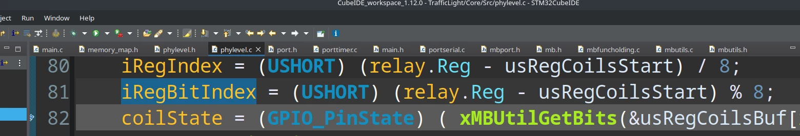

And this is what a breakpoint looks like with step-by-step debugging. It is practically invisible behind the arrow...:crying_face: 0693W00000bhQjkQAE.png

ATret.3
ATret.3Author
April 3, 2023
Thank you. So much better than with a tiny dot!
