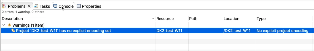

As for "No specific encoding" - ignore it.

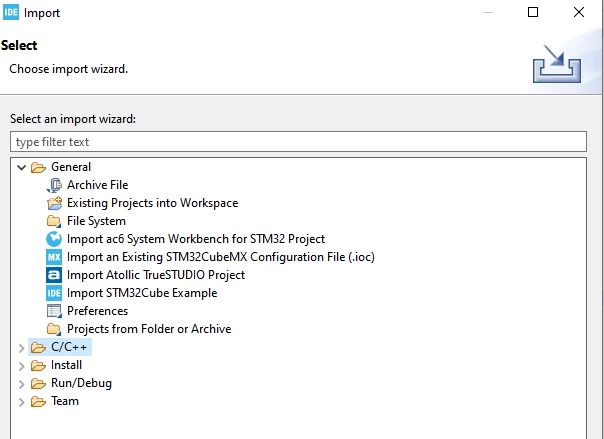

Which import option to choose?
Without RTFM impossible to import ?
* If the project is created for CubeIDE or already converted to CubeIDE: choose "Existing projects into workspace".
* If the project is for SW4STM32:  choose "Import ac6 ..."  Unless the imported project is in the Projects subtree of a Cube firmware package. Then it is an example, so use "Import STM32Cube example". This will open a special GUI.
* If the project is for Atollic, choose Atollic.
* Else it is not importable automatically.
