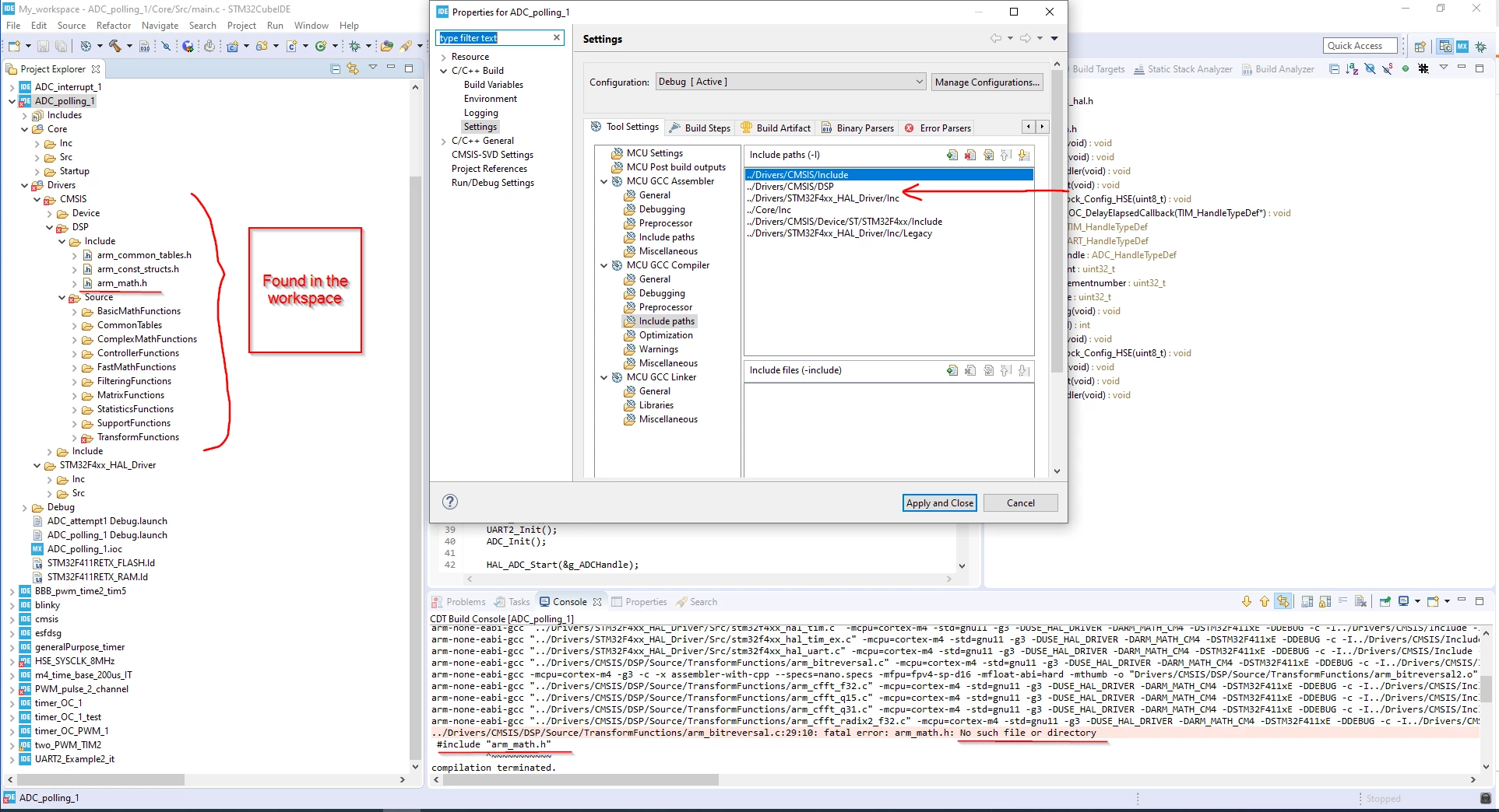

I want to use the DSP functions that are present in CMSIS. I'm using STM32CubeIDE with my target board being the ST32F411RE Discovery. Using CMSIS DSP with Keil uVision is extremely simple, you just select thew pack you want and use it but it's not so simple with STM32CubeIDE. CMSIS is included with the latest firmware pack STM32Cube_FW_F4_V1.24.2 but there doesn't seem to be any option within CubeMX or the IDE to add the DSP libraries (which are present in the firmware pack). The CORE libraries are added by default. I have added the DSP Include and Source folders to my workspace, I have added the include paths to the IDE but when I add
#include "arm_math.h
 to main.c
I get an error telling me that
fatal error: arm_math.h: No such file or directory
 and it is directed at each DSP source file.
I've spent the last few days trying to get past this. Has anyone used the CMSIS DSP functions in STM32CubeIDE and if so, how have they managed to set up CMSIS DSP to work with the IDE? Are there any further things that I could try with my setup? I'm surpised that the integrated CubeMX code generator doesn't provide the option to include DSP.

Set up your "Include Paths" properly so the compiler can find the files it is looking for.
Files are in ../CMSIS/DSP/Include not ../CMSIS/DSP

I knew the issue was a simple one, thank you I am now at least compiling without errors. Is there a way I can add DSP to the project automatically (or just an easier way) without having to copy and paste the DSP folders to the workspace from the firmware pack, adding the include paths AND adding the preprocessor define symbols? Again, thanks for the help.
