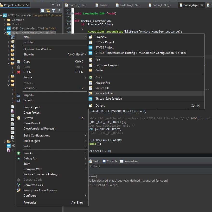

KBéla.1
March 8, 2024
Create Source Folder for filesystem where source files are available, instead of simple folder. See attachement.
Right click on project - New - Source Folder
And now the compiler can find the source files in Source Folder

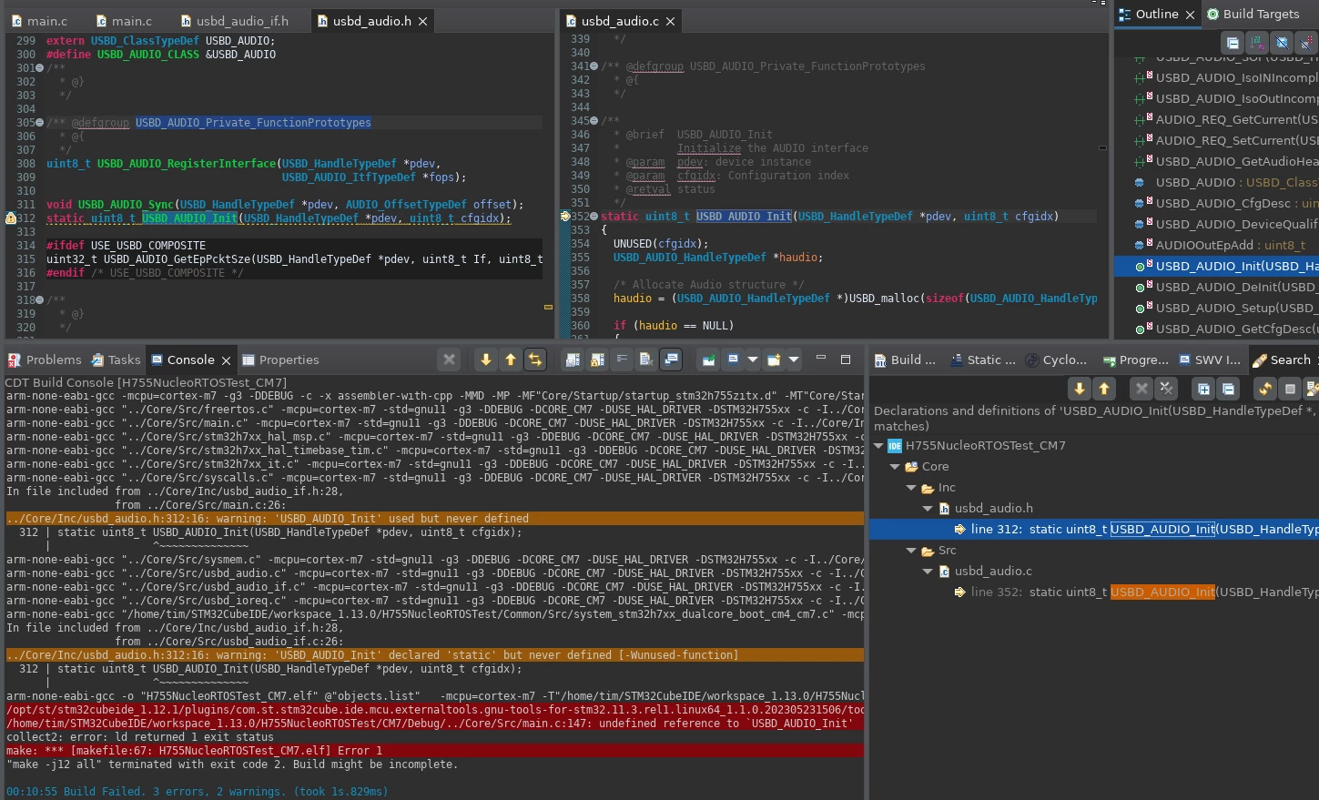

Visitor II
March 11, 2024
I've been struggling with setting up a USB audio device for the past week or so.. A few hours ago I found a reference to document UM1734 about working with the USB device library. I followed the instructions from paragraph 6.4.3, how to use the USB Audio class driver. It specifies to put a call to USBD_AUDIO_Init() in the setup. I did that but it turned out the library files were not even added to my project after setting up the device and generating code. (After selecting USB_OTG_FS under Connectivity and USB_Device_M7 under Middleware and setting it up to use the audio device class).
So I looked up which files I need to add and added them to my Src and Inc folders, but it turns out the USBD_AUDIO_Init() function was not even defined in the header file. So I added it, but when building, I keep getting the same error.
I looked at all the previous suggestions in this thread but none of them helped with this issue.. Building the code still reports an undefined reference to USBD_AUDIO_Init(), which is clearly not undefined as you can see in the screenshot. The files and folders are not excluded from build and as you can see in the build log, building them works fine. I see in the file explorer that the object file exists and it's listed in the subdir.mk file as well.
