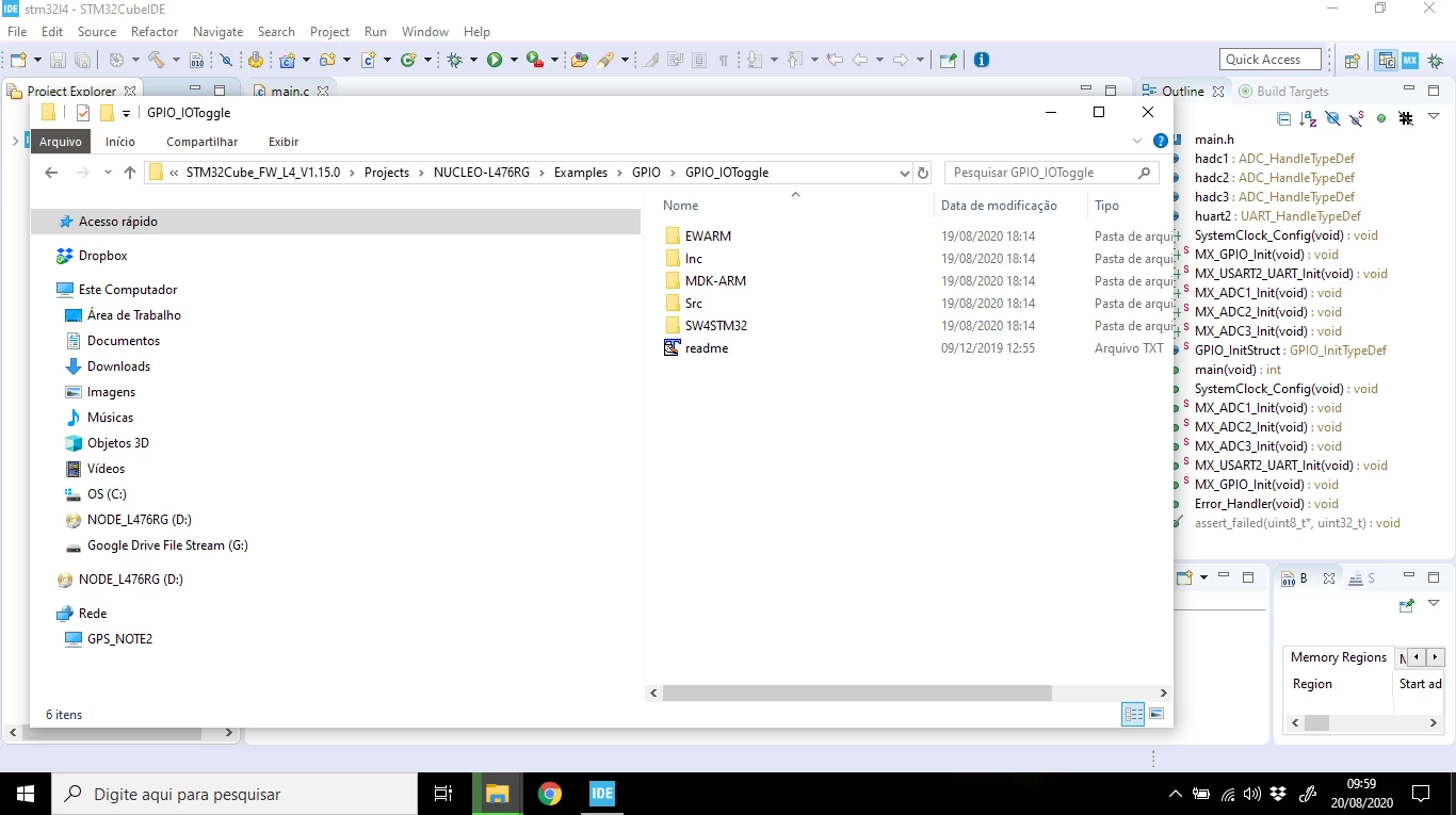

Geraldo Pereira
August 20, 2020
Thanks TDK,
I´ve located the Repository and downloaded 2 differentes versions of L4 package, 1.5 and 1.6. Folders: STM32Cube_FW_L4_V1.15.0 and STM32Cube_FW_L4_V1.16.0.
But there´s no folder named \STM32CubeIDE in the directory "C:\Users\geral\STM32Cube\Repository\STM32Cube_FW_L4_V1.15.0\Projects\NUCLEO-L476RG\Examples\GPIO\GPIO_IOToggle" as I read in the document "UM1860 User manual", page 17. So I think the document must be update, because a lot of beginners´ll be problem like me. See the attached image in this post.
So I´ve just opened the CubeIDE and tried import the folder "C:\Users\geral\STM32Cube\Repository\STM32Cube_FW_L4_V1.15.0\Projects\NUCLEO-L476RG\Examples\GPIO\GPIO_IOToggle". I located the project configuration to a project in the folder: C:\Users\geral\STM32Cube\Repository\STM32Cube_FW_L4_V1.15.0\Projects\NUCLEO-L476RG\Examples\GPIO\GPIO_IOToggle\SW4STM32\STM32L476RG_NUCLEO
I´ve just imported it. But now, when a Try compile the project I got the following error messages:

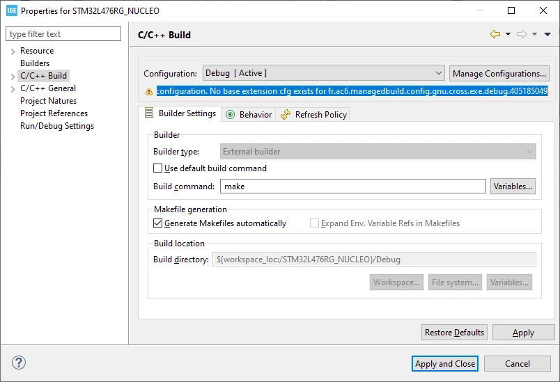

I´ve read the following warning in the C/C++ project configuration, see attached picture:
Orphaned configuration. No base extension cfg exists for fr.ac6.managedbuild.config.gnu.cross.exe.debug.405185049
Could you help or give me any hint?
Thanks,
Geraldo.
Pascal Bodin
February 18, 2021
Hi Geraldo,
Did you succeed in using STM32CubeIDE on the GPIO example? I tried to do the same thing yesterday, and did not succeed either. It seems that ST does not provide the STM32CubeIDE project, even if the documentation mentions it :(
Some time ago, I faced the same problem for some other ST code, and the only solution I found was to import the SW4STM32 project :(
