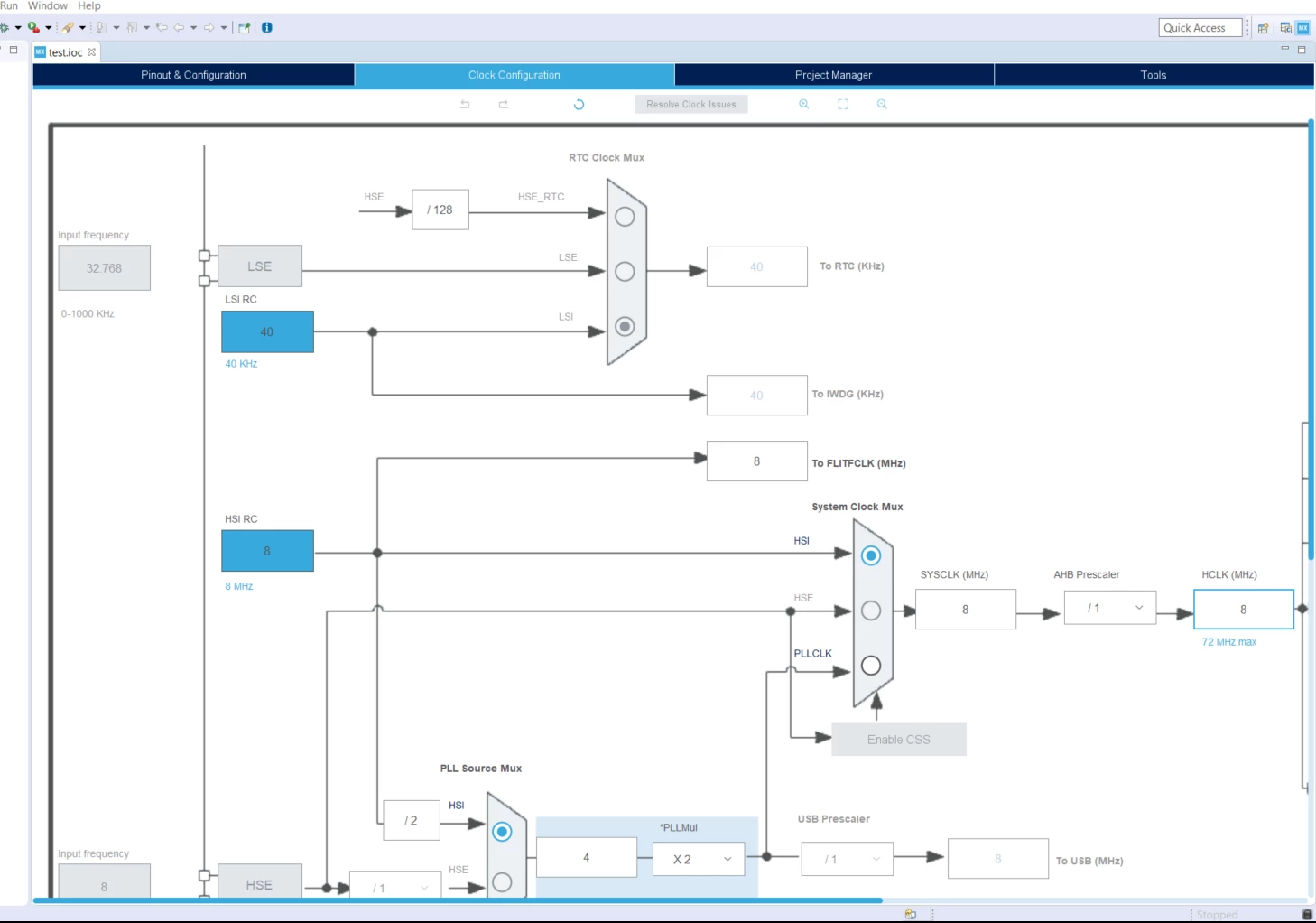

I have Accessability settings set up in Windows but CubeIDE seems to ignore them so the text is too small to read. Clock Configuration is scaled to fit in the page with no scrollbars whilst Project Manager uses about 1/16 of the available space
Best answer by MikeDB
Ah got it. Zoom and scrolling doesn't work if you have window maximized, but does if you set it to resizable. That's a bug.

Hello Mike,
Have you tried CTRL+mousewheel ?
MikeDB
MikeDBAuthor
Senior II
January 28, 2020
Yes. The lack of scrollbars seems to indicate they have been disabled in the sourcecode
Mike_ST
January 28, 2020
0690X00000BwkARQAZ.pngStrange, I have STM32CubeIde 1.2.0 on Win10, and I can see scrollbars and can zoom.
