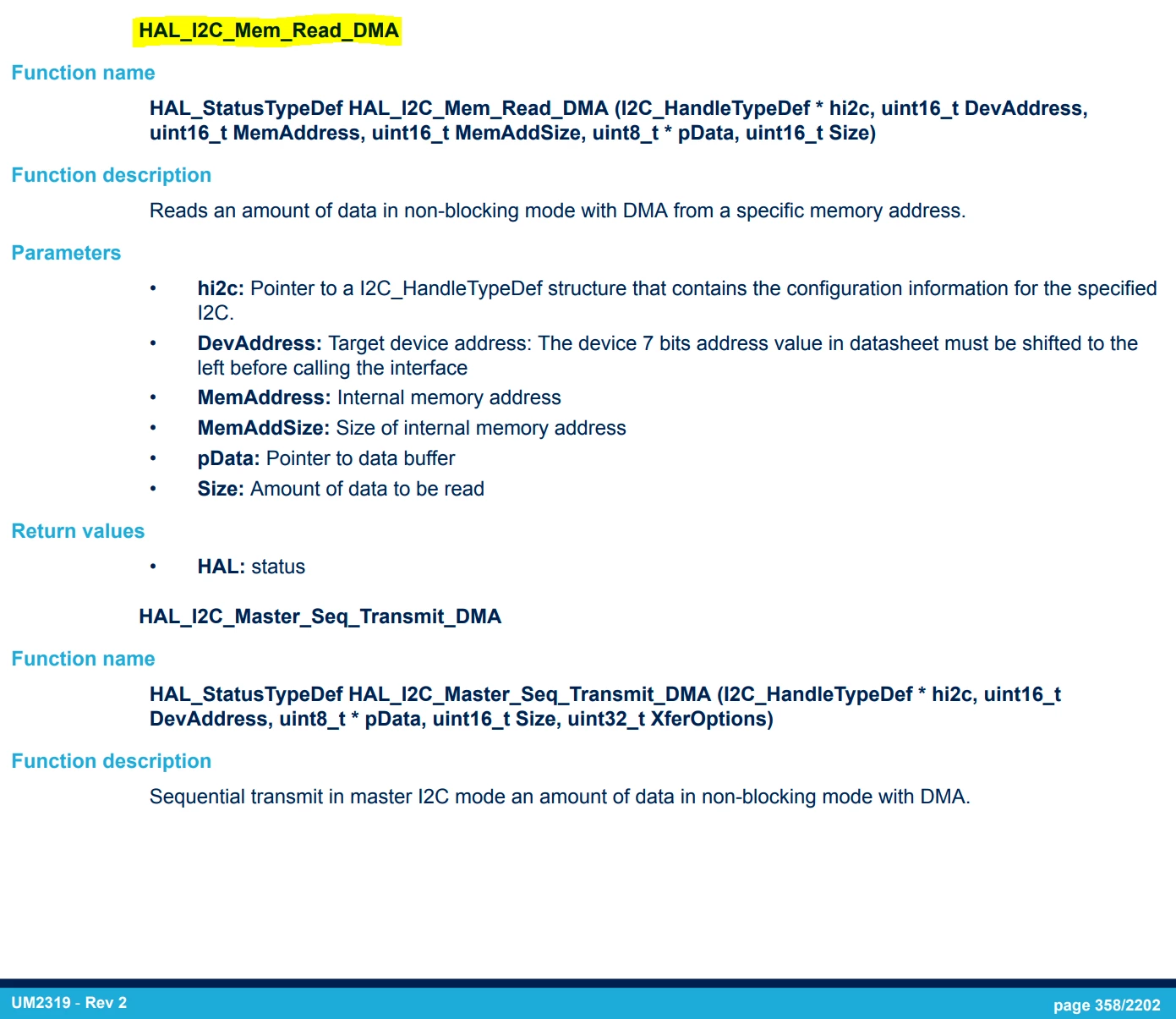

How do I update the HAL on an existing STM32G0 project?
I have a Nucleo-32 STM32G031K8.
STMCubeIDE was installed around March 1.
I have been trying to debug and getting slave code working to respond to HAL_I2C_Mem_Read_DMA() and HAL_I2C_Mem_Write_DMA() commands from another STM32G032K8.
When I looked at the U2319 (Rev 2 October 2020) documentation it says that the HAL_I2C_Mem_Read_DMA() had a timeout variable, but the documentation did not specify what units the timeout was. I am guessing milliseconds like the tick counter.
So I searched for the code, and discovered my code in the HAL file stm32g0xx.hal_i2c.c did NOT have a timeout variable.
So I went to the internet and grabbed another UM2319 from a Google search, and it was different, and the HAL_I2C_Mem_Read_DMA() did not have a timeout variable.
I looked at the Rev and it was Rev 1 October 2018. So either the documentation is wrong or somehow I have an old version of the HAL on my computer.
> It does NOT have the timeout like the UM2319 Rev 2 October 2020 says it does.
Where are you seeing that it says there is a timeout parameter?

Download the pack (Help -> Manage Embedded Software Packages), set the IOC file to use the new version, and regenerate the code.
If your project is not compatible with the code regeneration (e.g. code outside of USER CODE blocks), you'll need to replace files manually.
I don't think HAL_I2C_Mem_Read_DMA ever had a timeout, but could be wrong. More likely to be a documentation error.
HAL driver version is defined in stm32g0xx_hal.c file. Here it is for the F4:

While I was waiting for an answer I downloaded the latest version of STMCubeG0. It says 1.5.0
Just for grins I searched for HAL_I2C_Mem_Read_DMA() function.
HAL_StatusTypeDef HAL_I2C_Mem_Read_DMA(I2C_HandleTypeDef *hi2c, uint16_t DevAddress, uint16_t MemAddress,
                    uint16_t MemAddSize, uint8_t *pData, uint16_t Size)
It does NOT have the timeout like the UM2319 Rev 2 October 2020 says it does. I just wasted a half day searching for a problem that does not exist. Because the DOCUMENTATION was WRONG!

The earliest version of this driver on github is dated January 2020. No timeout parameter there, since 2020.

Sorry I screwed up. I thought I was looking at HAL_I2C_Mem_Read_DMA() in the documentation
And I was reading HAL_I2C_Mem_Read(), It is amazing what you can find after a good night's sleep.
Sorry for the false alarm. I have found so many documentation errors I was sure it was another one. This time it was not.
