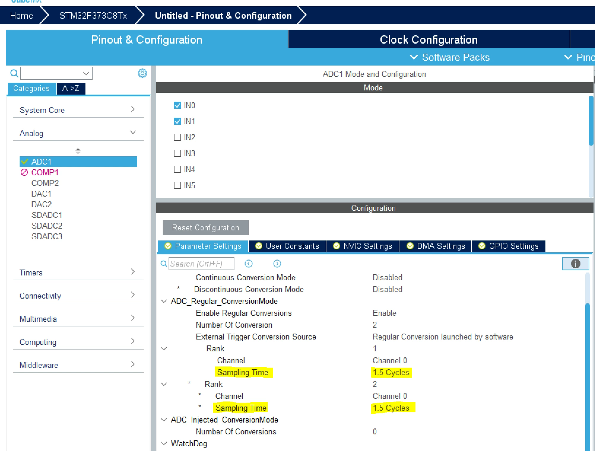

How do I specify the SamplingTime for ADC channels on an F373 in STM32CubeIDE?
In projects I've done with other STM32 MCUs, STM32CubeIDE allowed me to control the sampling time for individual ADC channels. However, with a new project (using a STM32F373C8Tx), I don't see where this option can be set.

In the ADC configuration, same as other chips. Ensure you have the number of channels you want set.

Ah. I missed the little arrow to the left of the "Rank" option. It needed to be expanded before I saw the Channel number and Sampling Time options.
