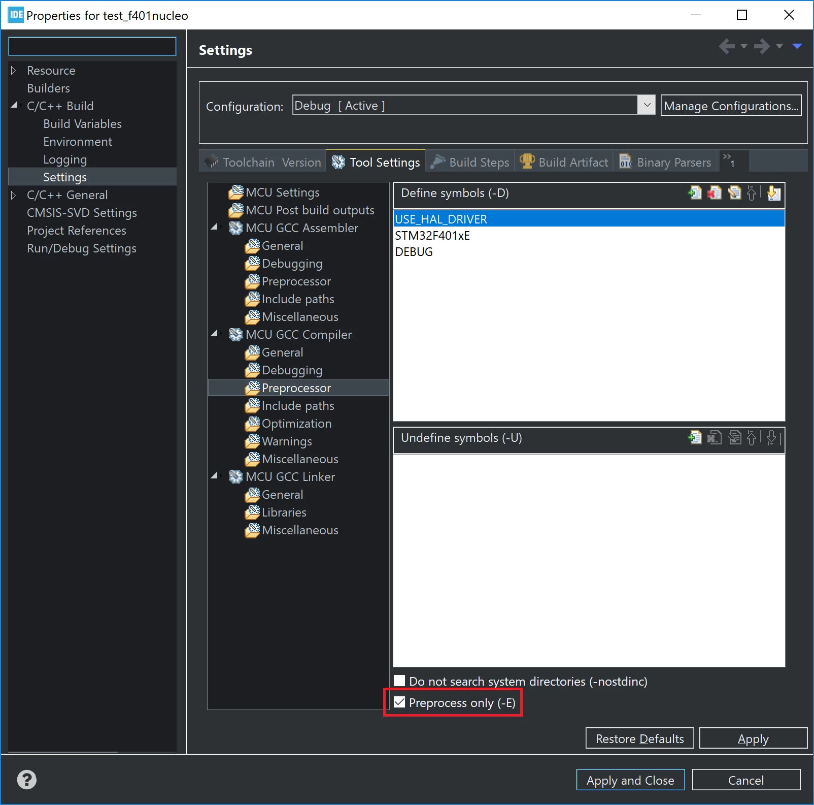

How do I see a C/C++ source file after preprocessing in STM32CubeIDE
I want to check if the preprocessing are correctly adding my function macros
TDKBest answer
Jul 29, 2020 1:27 PM UTC
Use the "Preprocess only" checkbox. After that, the converted files will be in the build directory with a "*.o" extension.

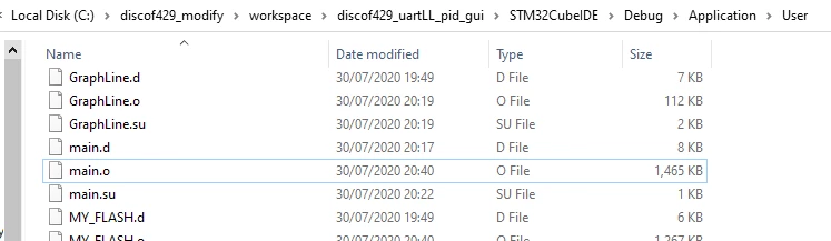

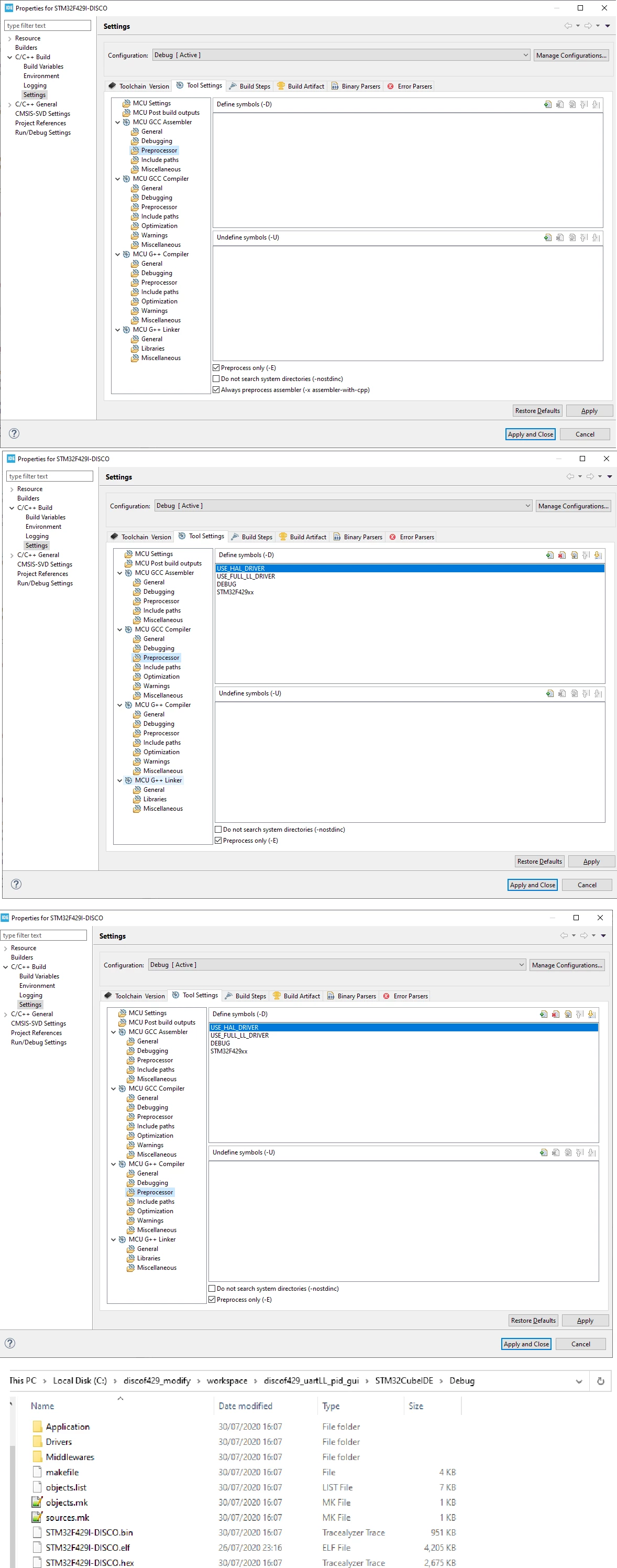

I checked the "Preprocess only" in all the places , and I open my Debug folder and sub directories ,I could not find the *.o extension. Am I doing it correctly?
EDIT: I found the main.o at last. It's in the sub directory users folder
