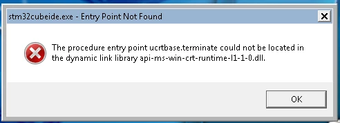

How do I resolve: "stm32cubeide.exe - Entry Point Not Found" when attempting to open the application.
The file "api-ms-win-crt-runtime-l1-1-0.dll" as per windows does exist in C:\Windows\SysWOW64
I get the same result after installing:
 en.st-stm32cubeide_1.11.0
and
 en.st-stm32cubeide_1.11.2
Any ideas?

It seems I missed an update. The offending missing files can be installed from here:
Update for Windows 7 (KB2999226)
https://www.microsoft.com/en-us/download/details.aspx?id=49077
And yes it's an old laptop!
