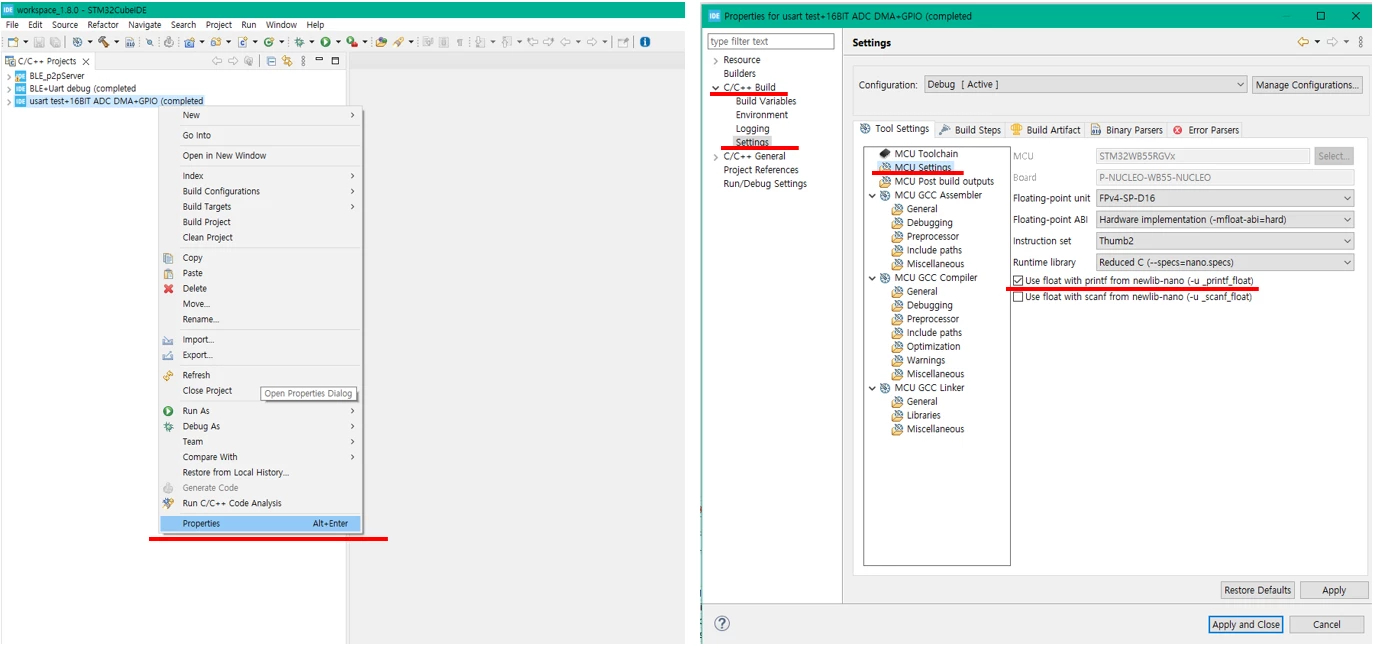

Your situation is very similar with me. I also started aduino and I'm working on stm32 from 1 month ago.
I also had a problem printing float number and I found that we have to activate an option before use printf() commend for float number.
follow is photo.0693W00000NpH2rQAF.pngFirst, right click of your project and enter the property. next go to c/c++ build/tool setting/MCU setting/ and check "Use float with printf from newlib-nano (-u _printf_float)".
Otherwise, you will see "?" massge only when you print float number.
To see the massage using UART, you can use printf() like below.
float abc = 3.123456
printf("massaga %.3f", abc);
result: massage 3.123
Visitor II
July 15, 2023
i am not getting float value only getting zeros even though i have changed the properties
RhSilicon
Lead
July 15, 2023
Try to clean the project (Project Menu, Clean) and see if any warning occurs.
