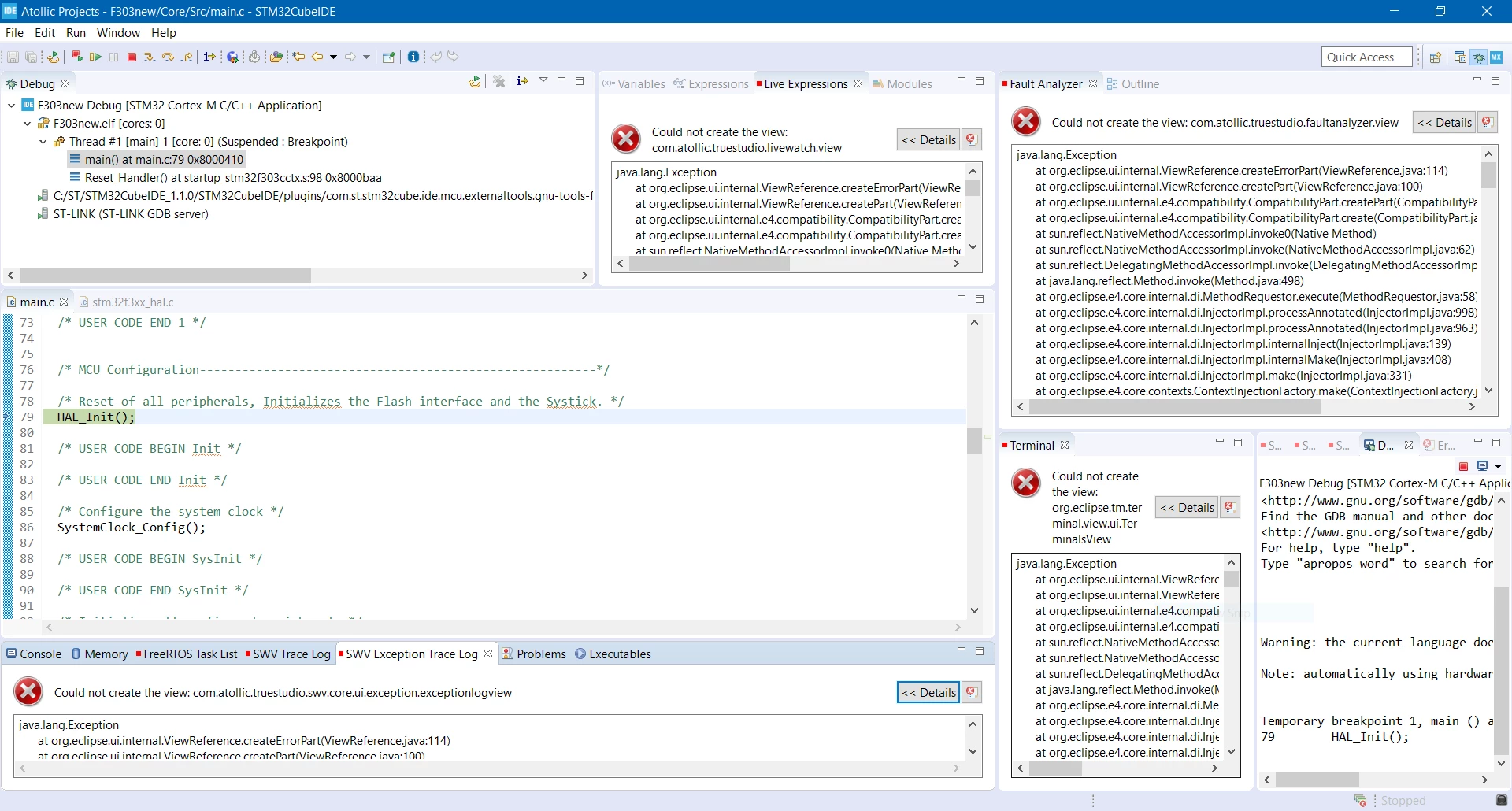

How do I get rid of the Java errors in live expressions?

Do you get these errors from all views? Or does it start to show up and then it will be that error for whatever view you open?
What version of STM32CubeIDE are you using and if you had a previous version did it happen there as well?
Also, if you could share your workspace log located at:
$Workspace/.metadata/log
That would be helpful.

I use STM32CubeIDE 1.1.0. I clicked a few tabs to open the views with the red squares, then for each of them I clicked details to show the full error. I used Atollic Studio until about a week back I learned about STM32CubeIDE, my current projects are all generated using the latter, but there are still projects in the workspace folder from the former.
In the log, the errors (starting from !ENTRY) repeat themselves.

I found a workaround: I uninstalled STM32CubeIDE 1.1.0 and installed 1.0.2 instead.

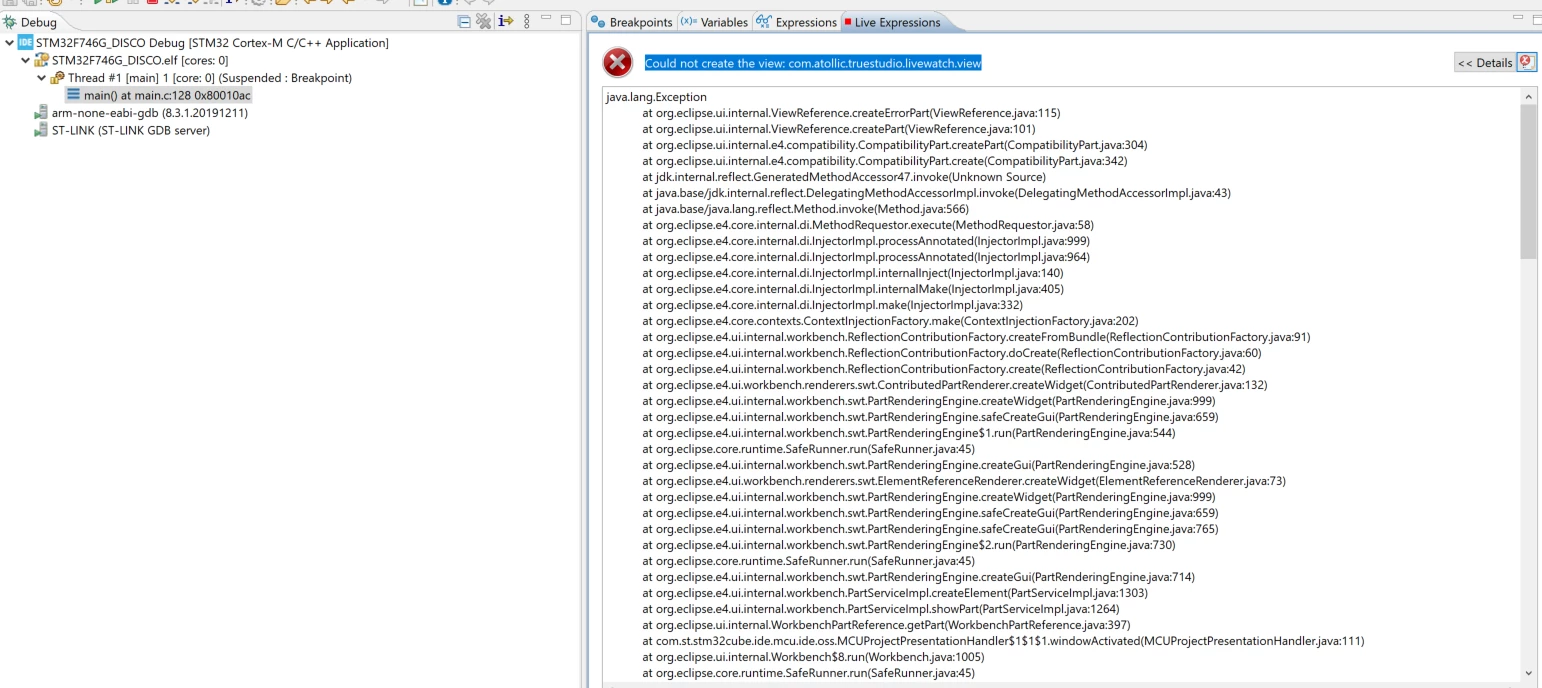

Hi, I am getting Java error(attached) while trying to use Live expressions. I am using CUBEIDE 1.7.0 Your help on this is much appreciated.
