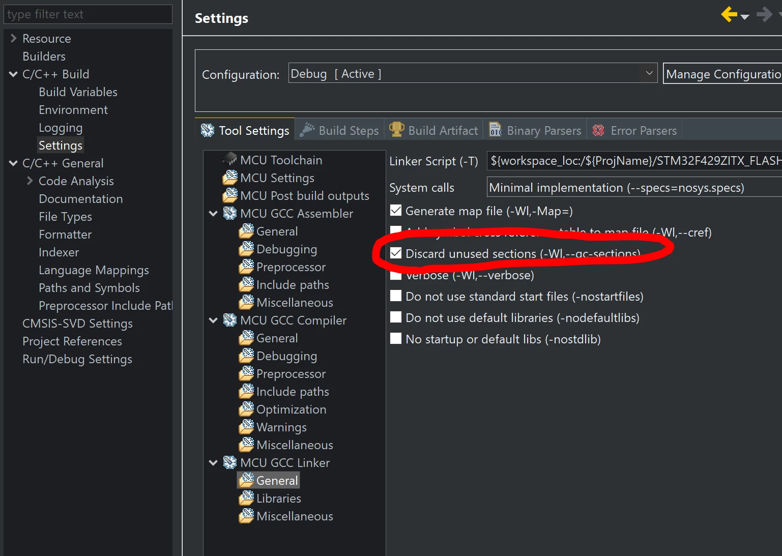

Greetings!
I'm using this printf library: https://github.com/mpaland/printf
And would like to completely disable the printf in the C Libraries that come with STM32CubeIDE. I went as far as renaming my printf to DBG, but when I look in the map file there is still printf included from the library. Here is an example:

Is there anyway to get rid of this extra code that I just do not want to use?

Not sure, but if I don't use printf, it doesn't appear in the map file. Are you sure it's not being used somewhere in the program? Is the replacement printf include appearing before all instances of printf?
There is this checkbox, but it had no effect for me when I tried it with printf.
As a note, I use the same printf replacement in my code. It works well.

That box is checked.
I did a global search for "printf" and don't see anything in the project other than things like vsnprintf_ that is in the third party library I mentioned.
I would have thought this would be trivial fix. I don't see a way to disable the nano lib, seems like it gets included in some form.

I guess technically you need to look for "printf_". If that's not in your map file, your program is not using the replacement printf library.
