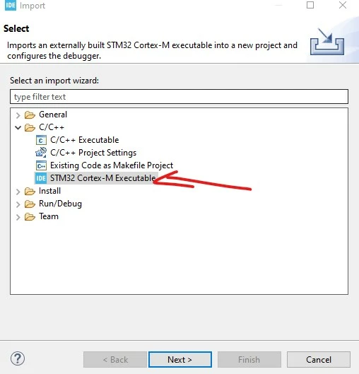

Cartu38 OpenDev
Graduate II
December 17, 2021
Even better File > Import > STM32 Cortex M executable
BSter.1
Visitor II
December 17, 2021
Absolutely true! Definitely the easiest way to solve the problem posed in the question.
My problem was a little different - I wanted to also be able to build my project via my own makefile using the STM32CubeIDE. Hence the new project creation in my answer. But I'm VERY glad someone else answered this as well - it took way too long for me to determine the solution.
