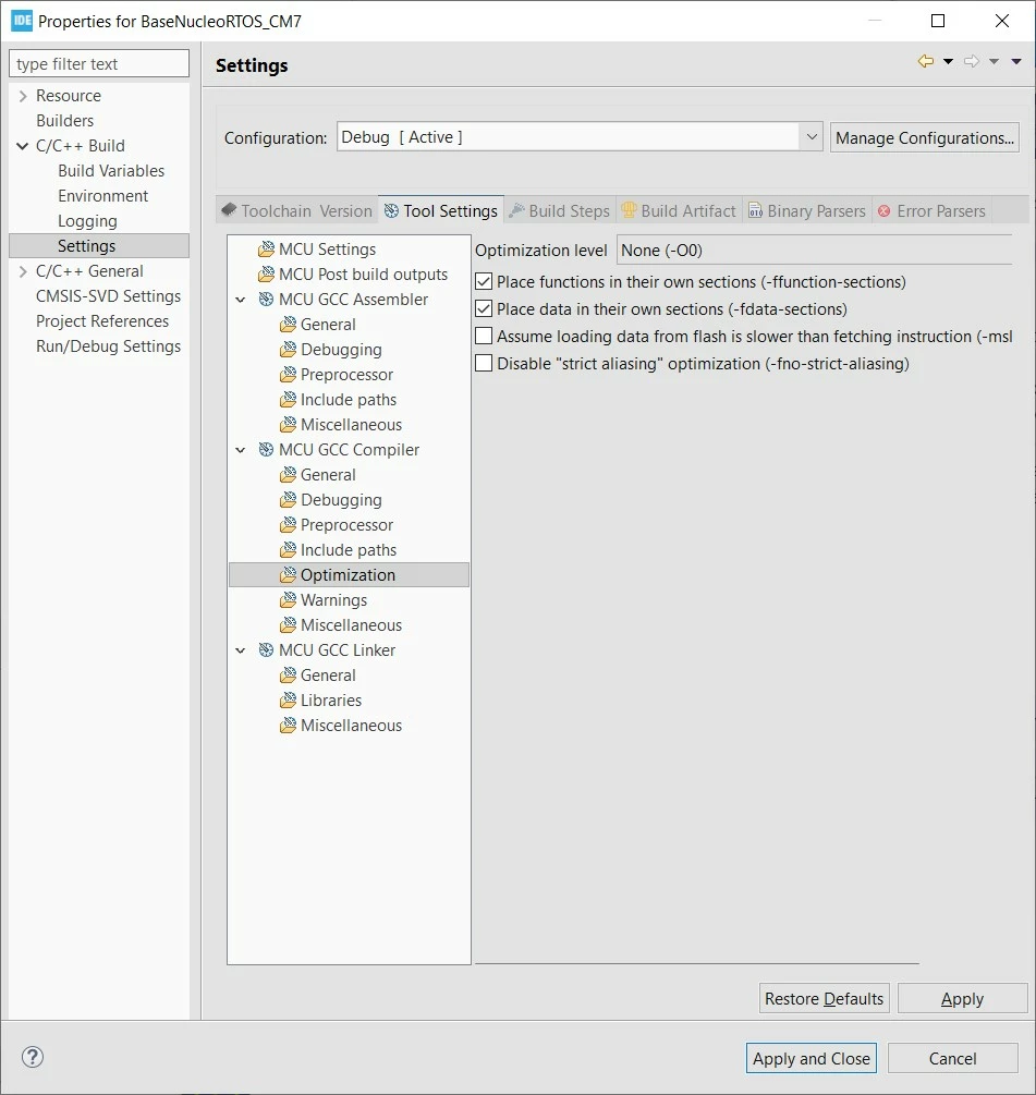

how do i change code optimization
  • March 25, 2020
  • 5 replies
  • 22150 views
I am using a nucleo-f401re board.
Best answer by TOlli
To change the code optimization level (in a general sense) do the following:
Right-click the project under Project Explorer
Select properties
Go to C/C++ Build->Settings
On the right hand side of the window, select "Tool Settings"
There, under corresponding compiler, you have the options for debugging and optimisation. Under these two menus, you should be able to change debuggin and optimization level for the compiler.
I have attached a picture of one of my example projects to show what you are looking for.0693W000000UmsGQAS.jpg
Best regards.
Select properties
Best regards.
JHule.1
JHule.1Author
March 26, 2020
Thank You, that worked, while watching the how to videos the guy says change the optimization level, but he was using Keil, that didn't do me any good when I was using STM32 Cube IDE, I looked for a user manual but ST didn't seem to have much.

September 6, 2023
As stated in solution,
  • Go to Project/Properties/ C-C++ Build/Settings/Tool Settings tab
  • Under MCU/GCC Compiler select Optimization
  • Optimization Level drop down is on top right.
Note that there are 2 build configurations, Debug and Release. You select the configurations under Project/Build Configuration/Set Active.

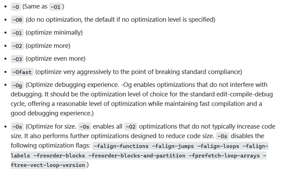

Levels are apparently universal to all GCC compilers. From https://stackoverflow.com/questions/1778538/how-many-gcc-optimization-levels-are-there
For debugging, I have been using the default (none) and have had no trouble with debugging. But if I do, I'll try -Og.
