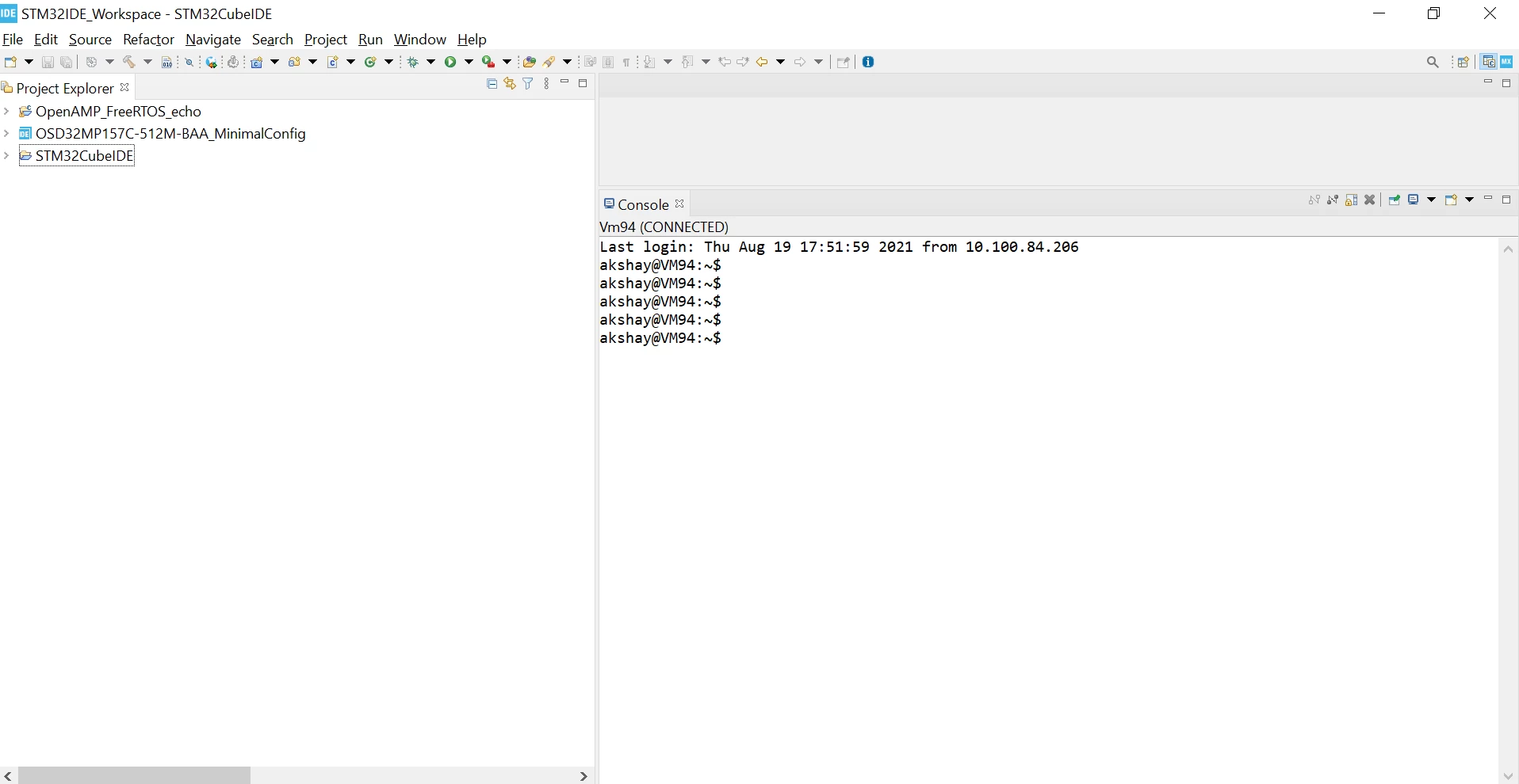

How can we modify the project present in remote connection using STM32CubeIDE.
Hi, i have added remote connection in STM32CubeIDE (preferences > Remote development > Remote connections)
Now i need to modify the project present in the folder of remote connection
How can i modify the project present in remote PC connection

Actually iam using stm32mp1 processor , so i want to modify the example M4 projects using STM32CUbeIDE which are present in linux Distribution package .
which is present in linux virtual machine which i can access only using SSH.
so i have created remote connection in STM32Cube IDE ,iam able to access the console of remote connection but iam unable to find any directory in project explorer.
FYI : the projects already present in project explorer are not from the virtual machine

my requirement is i have a remote linux PC which i can access only through ssh ,
Now my question is how can i import the M4 project example present in Distribution package which present in Linux PC and modify it using Cube IDE .
after modifying it i need to build linux image along with the m4 project in linux PC without copying and pasting the M4 example in Distribution package.
