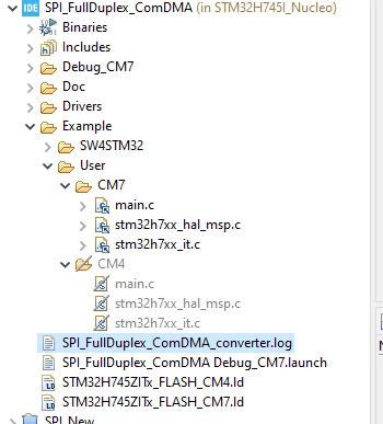

How can run the example in stmcube to stmcubeide
  • July 13, 2021
  • 1783 views
The example given in STMCUBEMX its support keil,ARM .I have to run that example on STMCUBEIDE someone tell me how I can run the example on CUBEIDE.

MDeva.1
MDeva.1Author
July 19, 2021
Sorry for late replying. I update the version of stmcubeide.But when project is open CM4 files are not opened. On CM4 cross marking is showing. So only CM7 .elf is getting.0693W00000CzwJGQAZ.png

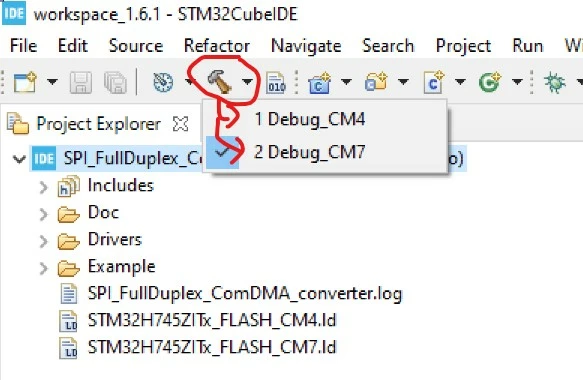

Cartu38 OpenDev
Graduate II
July 19, 2021
@MDeva.1​  such is expected according to me.
To compile CM4 or CM7 part you have to move from one build configuration to another.
Such example project is not a STM32CubeIDE native one but a SW4STM32 legacy one STM32CubeIDE is able to import. Way to support such multi cpu devices like H7 is not exactly the same then.
