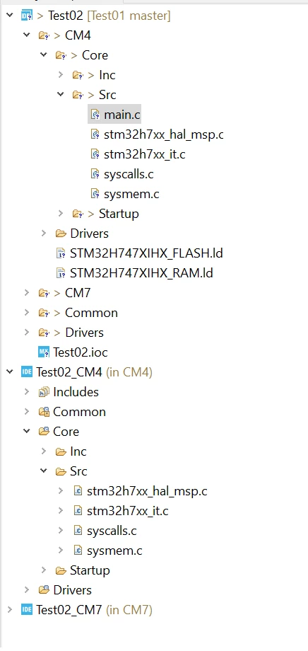

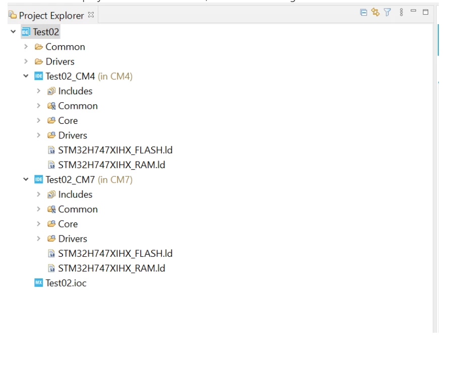

JSchn.4
February 19, 2021
Hmm, I am a newbie to STM32Cube as well, but so far I am fairly impressed, by the professional architecture of this IDE. So I tend to believe, that we must do something wrong.
I discovered, that the GIT integration changes the project structure. This is, what the project looked like before connecting it to the GIT:
And this is, what it looks like afterwards:
Dont really understand why it moves the independent projects for the two different cores unter one project.
Hope anybody can advice!
Johannes

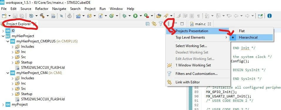

Cartu38 OpenDev
Graduate II
February 20, 2021
Not related to Git I guess. Both snapshots are same just graphical view setup is not same.
Rely on project explorer view than enable hierarchical view:
