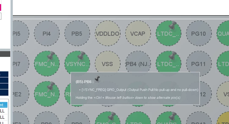

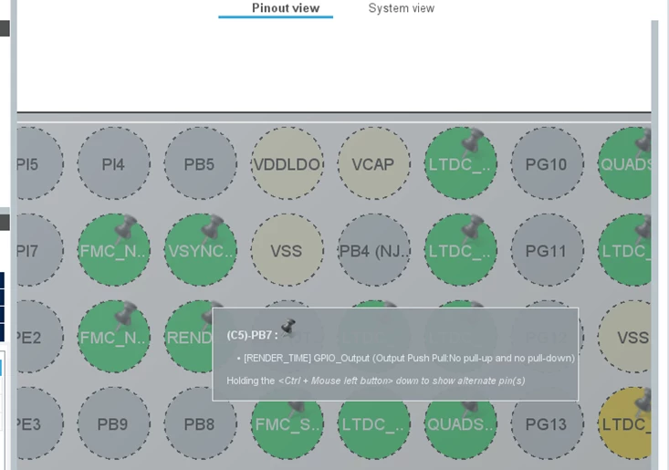

I have a stm32H745I-Disco and I would like to use some UART and I would need it to be through one of the pins that the board has called arduino connectors.
I was able to use the USART1 without problem but now I want to use it together with the display and I realize that the pins PB6 and PB7 are being used by vsync_freq and render_time.
What can I do?

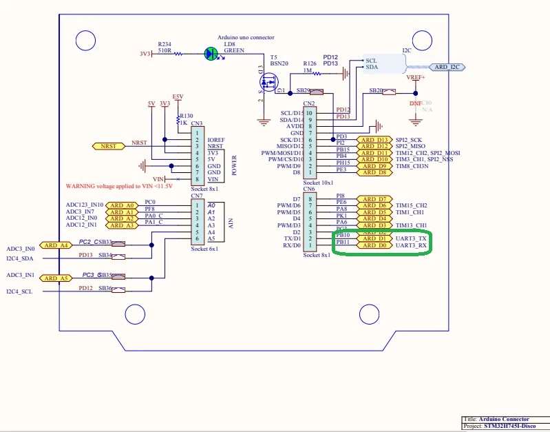

The schematic is : https://www.st.com/resource/en/schematic_pack/mb1381-h750xb-b01-schematic.pdf

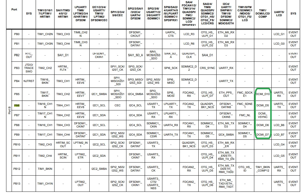

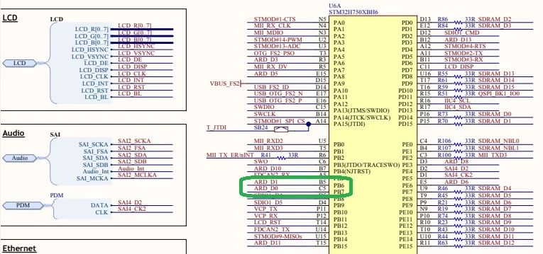

Show me this on the MB1381-B schematic for the H745I / H750I DISCO board..
Not associated with SCREEN/DISPLAY, only DCMI
LCD_VSYNC is PI9
Are you sure you're using the right board template?
@STTwo-32 This schematic is unhelpful, the ARD_D0/ARD_D1 connect to PB7 / PB6 USART1 / LPUART1

Doesn't PB6/PB7 clash with the CAMERA (DCMI) not the DISPLAY

Hello Tesla DeLorean
STM32Cubeide indicates the following:
and if I am not mistaken in PB6 named B5 in the schematic it says that it is connected to a pin of the LCD.
