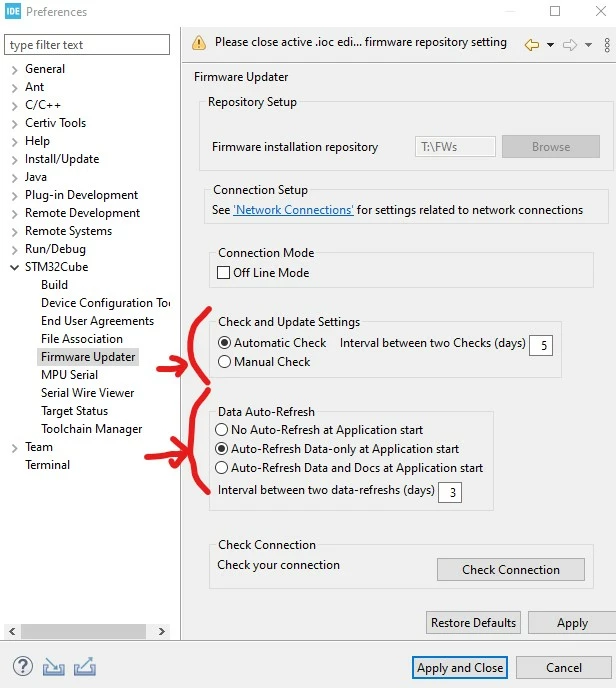

How can I stop CUBEIDE to download zip files every time?
The files that is downloaded looks like the same every time and I use only one M3 core device,so why is it downloading the zip files every day?

About which .zip file are we discussing here ?
If target selector ones let's rely on dedicated preferences:

Thanks.
Now I know where to change the setting,was set for Update once a day.
The files that is downloaded and unzipped is something like STMCUBE_FW_1.*** cant remember exactly but its 9.5Meg every time .
Then there is another file of 21Meg and some small fast downloads.
