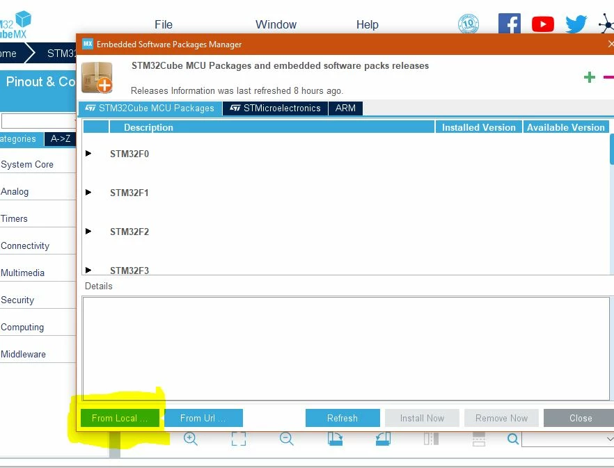

How can I install the .zip file en.stm32h7_v1-8-0.zip
How to install it manually. IS there a oportunity to install it and keep it as a .zip-file?​

You can use STM32CubeIDE or STM32CubeMX to install the downloaded .zip file (STM32CubeIDE: Help > Manage Emb. SW Packages > From Local...)
The .zip file will be copied and unzipped to %USERPROFILE%\STM32Cube\Repository (win) or $HOME/STM32Cube/Repository (Linux). The .zip file stays there for reference.

Zip file must be deployed. Can't work as zip only in repository
CUBMX >Help> Manage embedded software packgages
