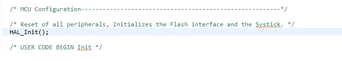

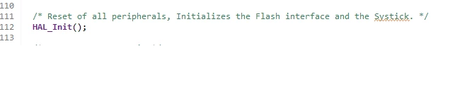

How can i have syntax highlight for funtion like HAL_Init(); as in the attached files? Thanks

Does anyone know of the reason for this. I have the same issue when I start a new project from .ioc file. If i imported an example project the syntax highlighting works fine.

I still have the same problem. But I have seen that if you add the file as "link" to your project, the colour changes.

Found a way of helping highlight the functions normally:
go to 'Window' tab > Preferences > C/C++ > Editor > Syntax Coloring Then go into 'Code > Functions' and enable it and choose your highlighting colour etc.

Then it looks like the project that you've imported has local settings that affect the coloring. It overrides the workspace level settings.
