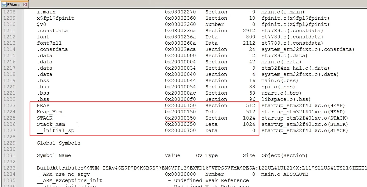

How can I determine the starting address of the stack in CubeIDE?
In Keil, if you open a file with the extension .map, you can find information about starting address of stack and so on. See screen.

    In the Keil builds the initial stack is set to __initial_sp, and descends too Stack_Mem

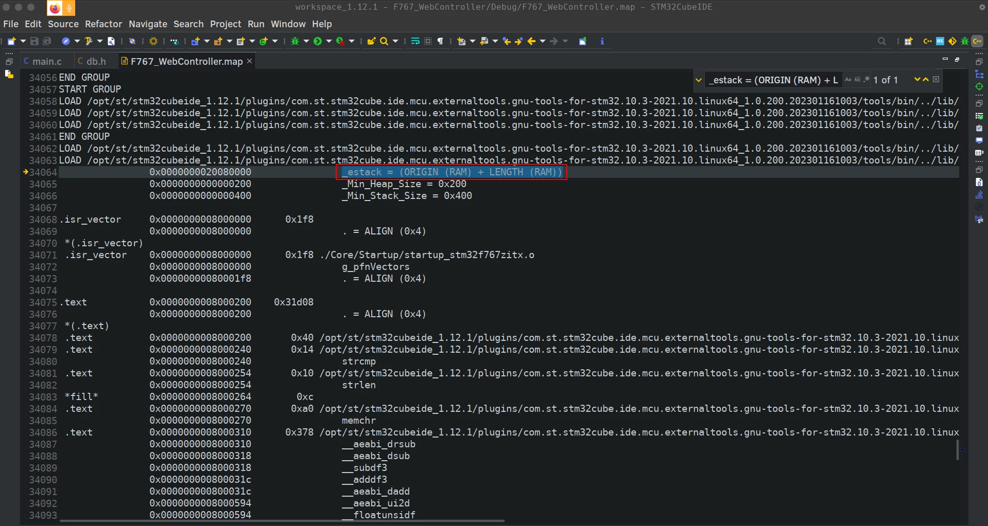

    Go to STM32CubeIDE\Debug and open .map file. Try to find the line
    _estack = (ORIGIN (RAM) + LENGTH (RAM))

    Thanks for the answer!
    I found the desired line in .map file

    Thank you, but how to find out the end address of stack from this file?
    mƎALLEm
    January 26, 2024
    _estack defines the end of the Stack which is the Top of the stack.
    So normally the stack starts at: _estack - _Min_Stack_Size
