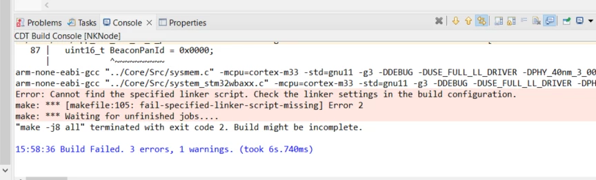

I'm using STM32CubeIDE 2.0 and CubeMX 6.16.1. When I create a project in CubeMX, it doesn't create the STM32WBA55CGUX_FLASH.ld file. It creates the makefile when I select it in the Toolchain/IDE section, but then gives an error.

Hello @YBAYR.1
Thank you for bringing this up!
Could you please check the project directory to confirm if the STM32WBA55CGUX_FLASH.ld file is not present?

The STM32WBA55CGUX_FLASH.ld file doesn't exist initially.
I can create it using CubeMX with toolchain/ide:makefile, but I get an error in the compiler.
December 18, 2025
CubeMX should add linker file titled "STM32WBA55xx_FLASH.ld" instead of "STM32WBA55CGUX_FLASH.ld".
can you check please?
