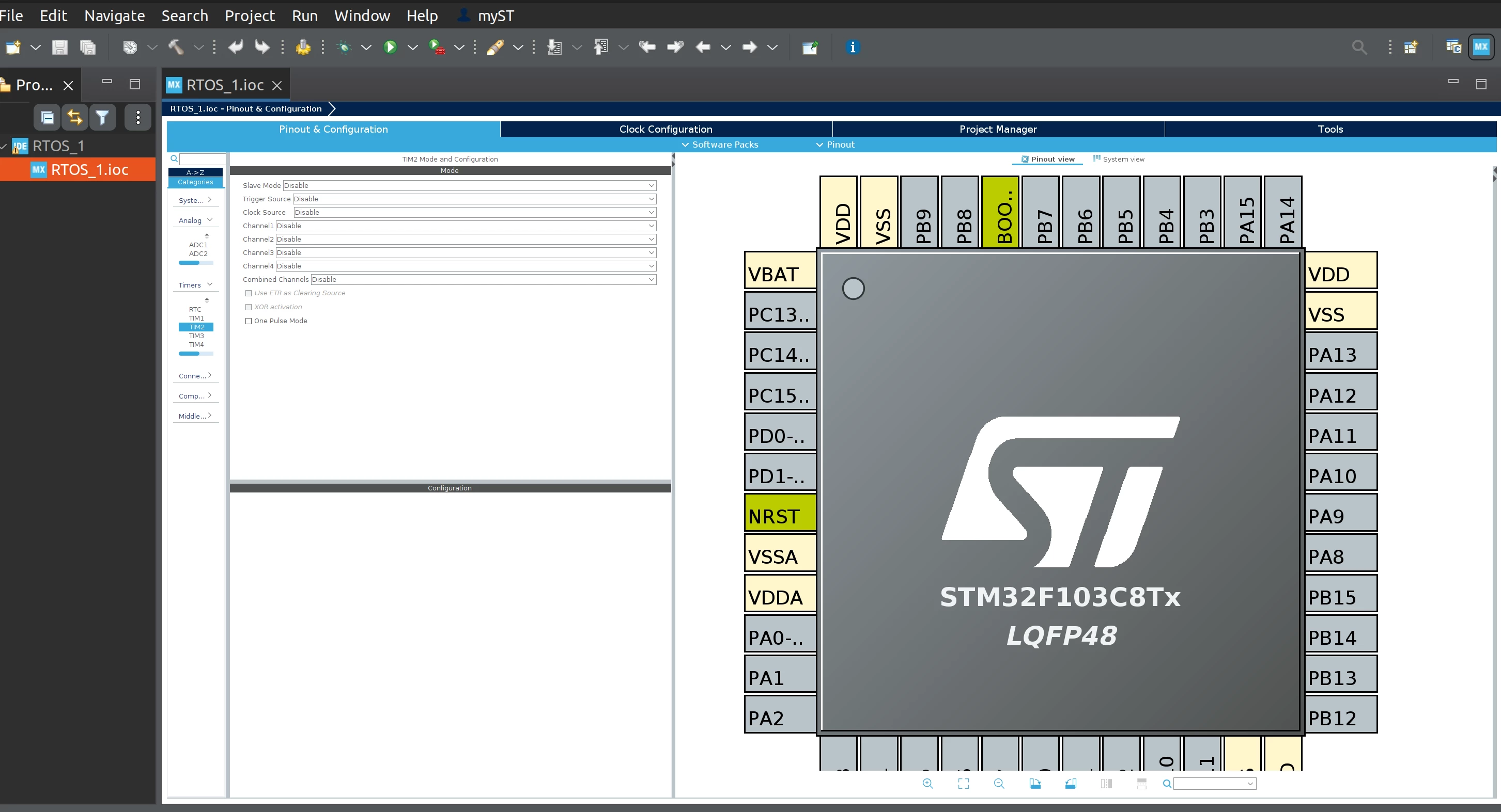

How can I change UI size in .ioc file view?
Hello community!!
I'm using Ubuntu 22.04 with 4k monitor and my fractional scaling set to 175%, and this is what I get in STM32CubeIDE .ioc file view, which is too small to read.
I tried toggling some font settings in Window > Appearance, but didn't work.
Therefore I want to know if there's a way to change the UI size or font size of the view?

    Hi @deliverredt
    Thanks for the reply but everything else in eclipse is fine, it is just the ioc viewer that is wonky.
    I just found a solution though:
    1. Quit stm32cubeide
    2. install the standalone STM32CubeMX app, run it, at the top click window and then Choose the size you want.
    3. Quit STM32CubeMX
    4. Start stm32cubeide and the ioc viewer will use those settings.
    Thanks
    Andy
    July 9, 2024
    Thanks man, it is still to small, but at least it is a little bigger now.
