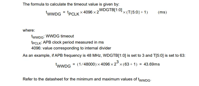

How can I calculate an approximate IWDG window ?
Development Board: Nucleo-L476RG.
IDE version: STM Cube IDE 1.11.0
For the system watchdog timer, there's an equation(attached.) Is there an equivalent equation for the IWDG ?
Any suggestions would be appreciated.
Thanks

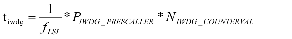

Thank you for your question. As you may know, the independent watchdog is based on a 12-bit downcounter and 8-bit prescaler.
Indeed, there is an equivalent equation to calculate the refresh interval :0693W00000Y7r5nQAB.pngIn the formula above,
Flsi is equal to an independent 32 kHz internal RC (LSI).
Piwdg_prescaler is the prescaler value.
Niwdg_counterval is the downcounter reload value.
You can configure the two last parameters in STM32CubeMX > Pinout & Configuration > System Core > IWDG > Configuration once the IWDG is activated.
As conclusion, you need to refresh the IWDG before the 12-bit downcounter reaches the zero value. So the Tiwdg time is the maximum delay.
If you have any other questions or suggestions, don't hesitate to ask.
Pierre
