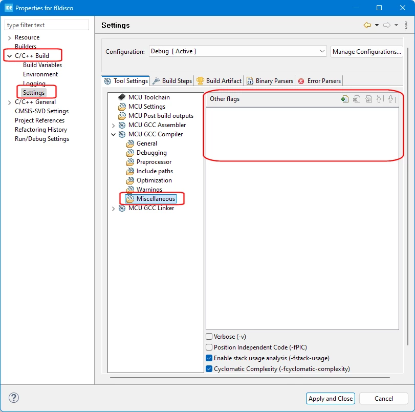

How can I add the [-Wenum-conversion] warning check?
If I check the "Warn for implicit conversion (-Wconsersion) I have many warnings from ST originated files (stm32l4xx.h) so I can not use this option....

Without the square brackets ?

In general, you can add any arbitrary options here:
