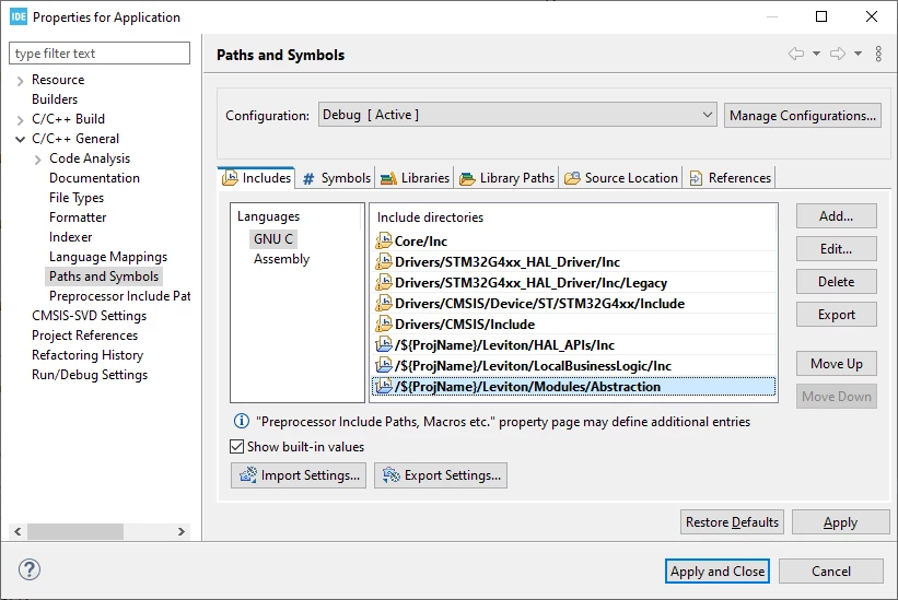

I have gotten this to work, but one of the files I have linked to my project is an include file.  When I try to make the project I get an error saying that the .h file does not exist.  I tried adding a path to the project as seen in the following screen capture, but it appears that the compiler is not taking the file link.  How can this be resolved?
RLein.1
Mar 17, 2025 9:27 PM UTC
I discovered the solution.  You need to select File System instead of Workspace when creating the path
