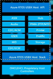

AScha.3
April 12, 2023
so CDC host from STM is similar to AUDIO host : not useful working.
did someone try the "Azure" host ? seems there are many host types...
https://github.com/azure-rtos/usbx
shorai
April 12, 2023
Hmmm, was getting there, but that looks like the perfect solutoin!
Thank you very much!

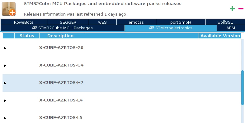

AScha.3
April 12, 2023
+ can add in cubeIDE :
shorai
April 13, 2023
Thanks again for rthe pointer to Azure,
The H7xx seem to be the most complete
I'm running 746 and 769 discovery boards, and so need to learn a bit more and can probably adapt the ACM driver with not too much effort.
I think most of the config can be done via the config panels in cube ;) and a 'class' for each manufacturer of USB to Serial bridge to get round the enumeration step for 'vendor specific' where class does not come in as 2.
