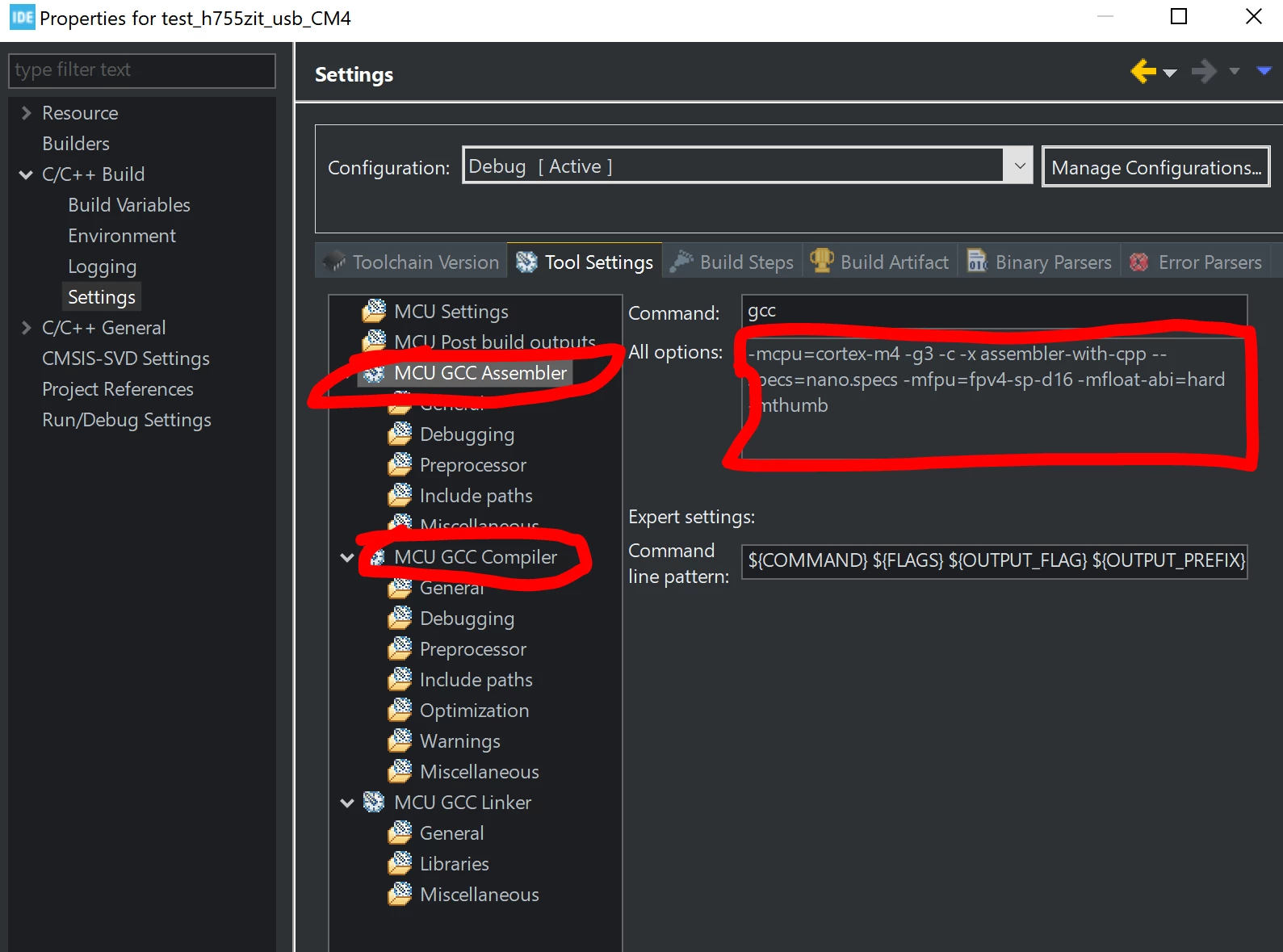

May 4, 2021
Right click project -> C/C++ Build -> Settings -> Tool settings
They are changed from within there.

May 4, 2021
Thanks for the reply. I have already looked in there and although it gives some of the flags it is not an exhaustive list.
