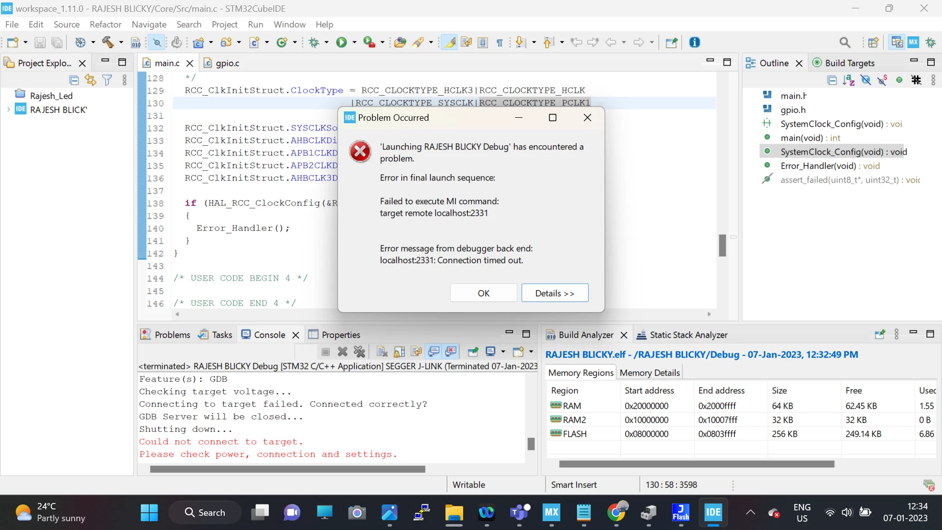

hi today i wrote a led blicky code in stm32cubemx and i am using external j link debugger to flash a code but i am getting a error like this.

No This board(LORA-E5 DEV BOARD(stm32wle5jc controller)) does not have onboard STLink.so i connected external j-Link debugger for code flash in stm32cubeide. but i am getting error like that. sir can help me how to resolve this problem.

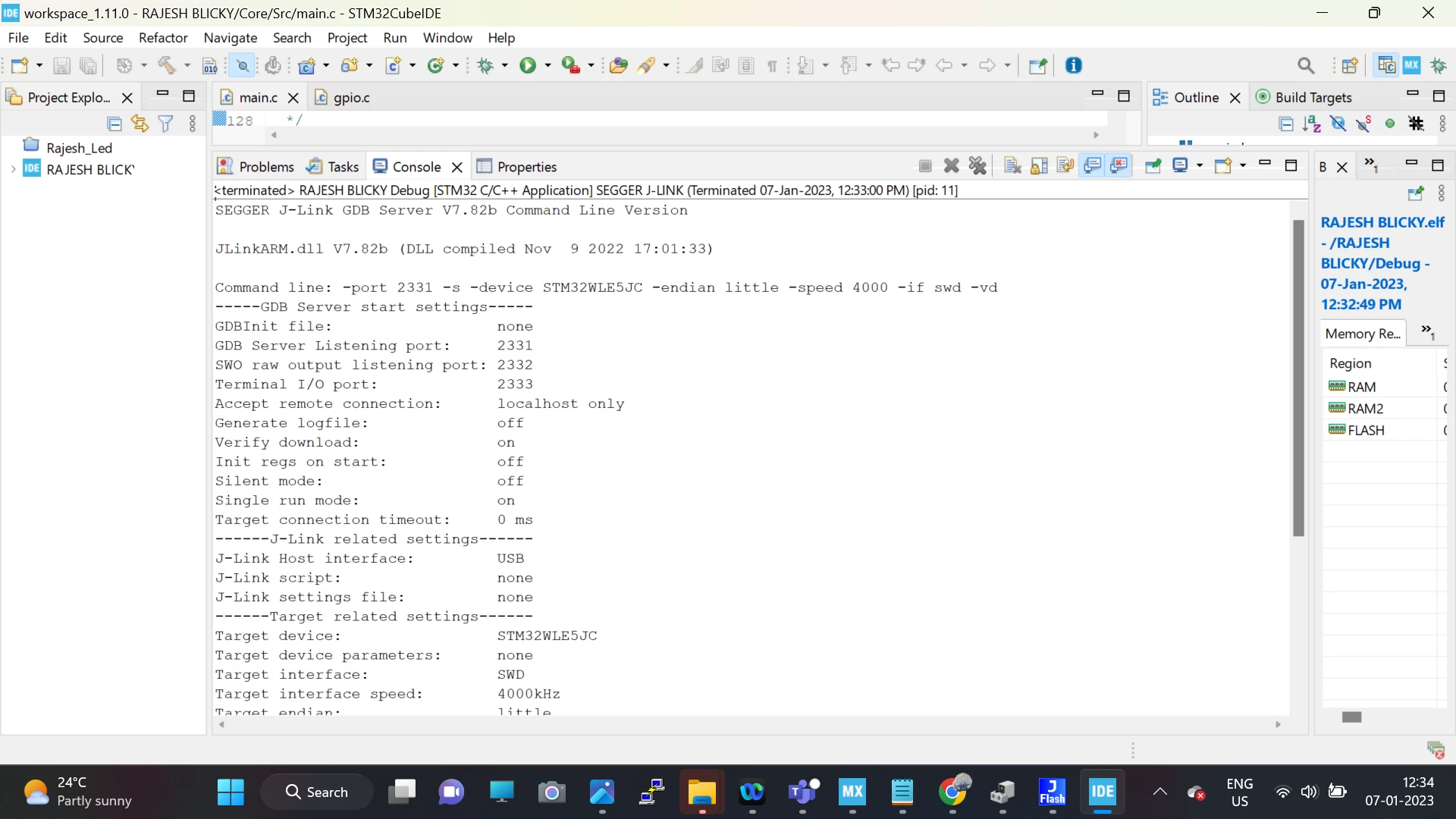

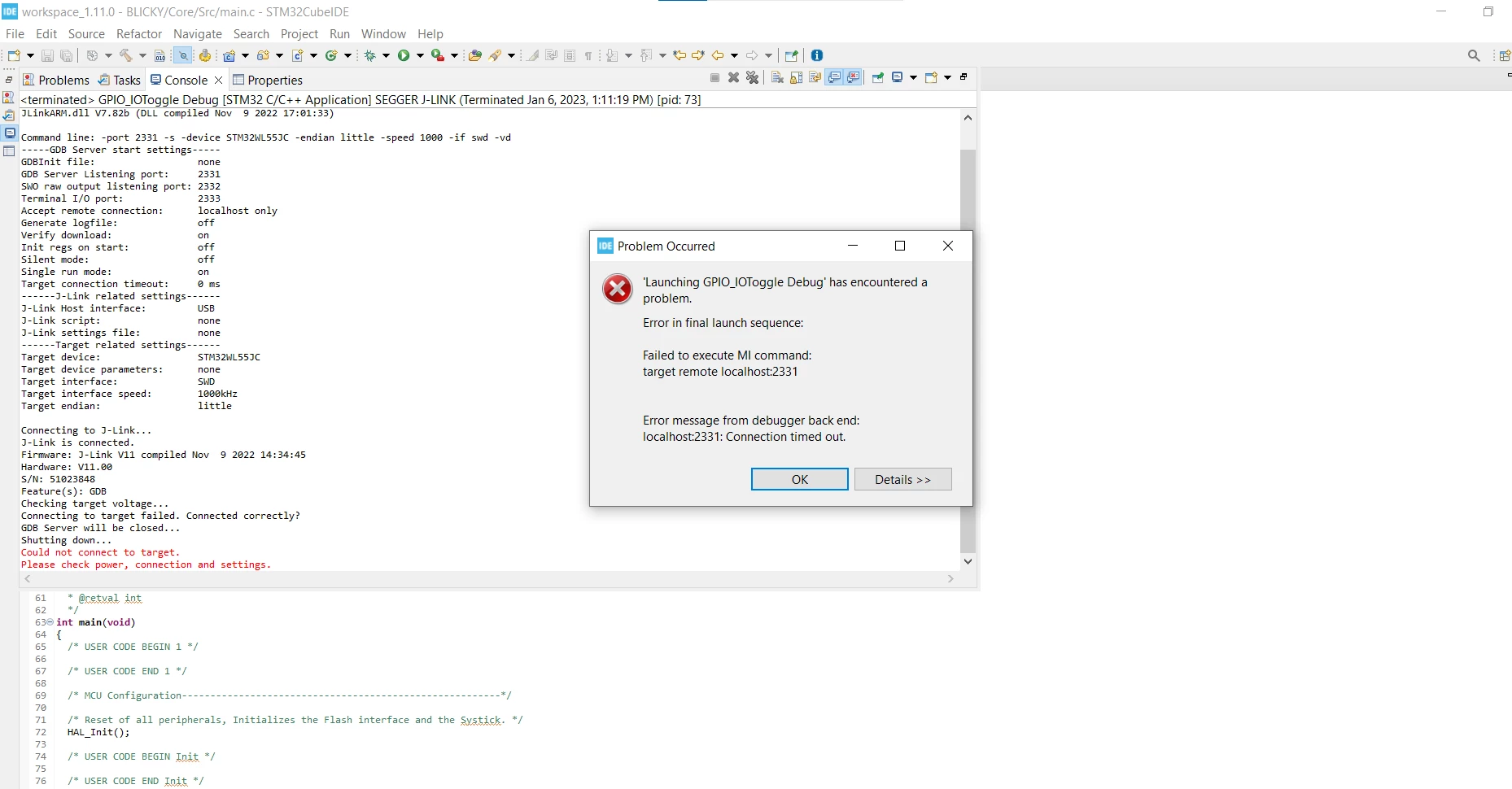

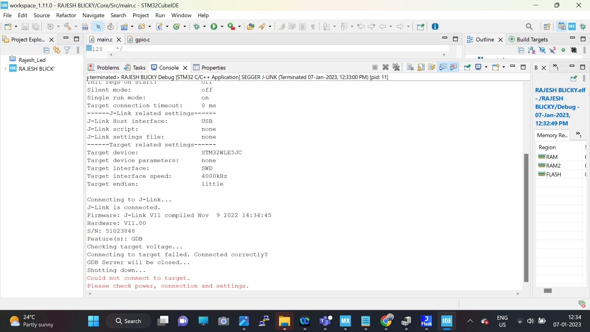

I have checked logs, J-Link connected but it showing below error.
Could you please share how to connect the power lines to JTag. if you have any connection diagram, please share us.
I have attached screen shots of below errors. Kindly check.0693W00000Y7d5UQAR.png0693W00000Y7d5PQAR.png0693W00000Y7d5KQAR.png
Could not connect to target.
Please check power, connection and settings.
Checking target voltage...
Connecting to target failed. Connected correctly?
Error in final launch sequence:
Failed to execute MI command:
target remote localhost:2331
Error message from debugger back end:
localhost:2331: Connection timed out.
