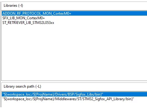

Hi The goal is to convert the Sigfox_Button example in STSW-S2LP-SFX-DK from Keil IDE to STM32CubeIDE.
I adjust the code and now I don't have compiler errors but I have 3 link errors.
The 3 library that I added in the link section are not found. I remove the extension
when add them in the list and set the files correct path.
The attachments show my settings and the error.

Looks like it wants actual file names and paths
Keil libraries whilst in ELF format, might have different expectations than GNU/GCC

Hi Tesla
Thank you for your suggestion.
I tried to provide the full path and also tried to rename the library from .a to .lib.
Unfortunately I was unable to solve the problem

Hi Tesla
I found the problem on your suggestion. It's a libraries compatibility
Thanks for your Help
