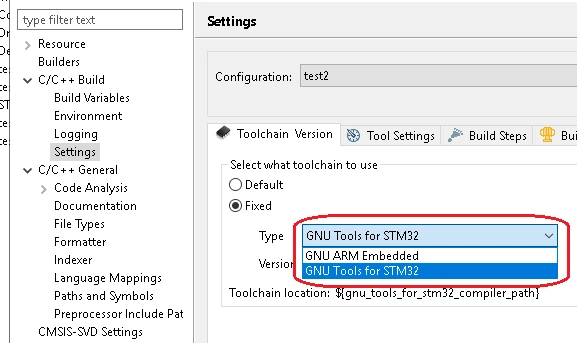

Hi, I'm looking for some examples of how to update GCC from default 7.3 to e.g. 9.2 in CubeIDE, could anyone help? thank you!

Hello AlexKokushin,
Can you try the following:
1) Install the desired version of the gcc
2) Right click on the stm32cubeide project -> Properties
3) See the attached pic
Regards,
Ajish Gopal R

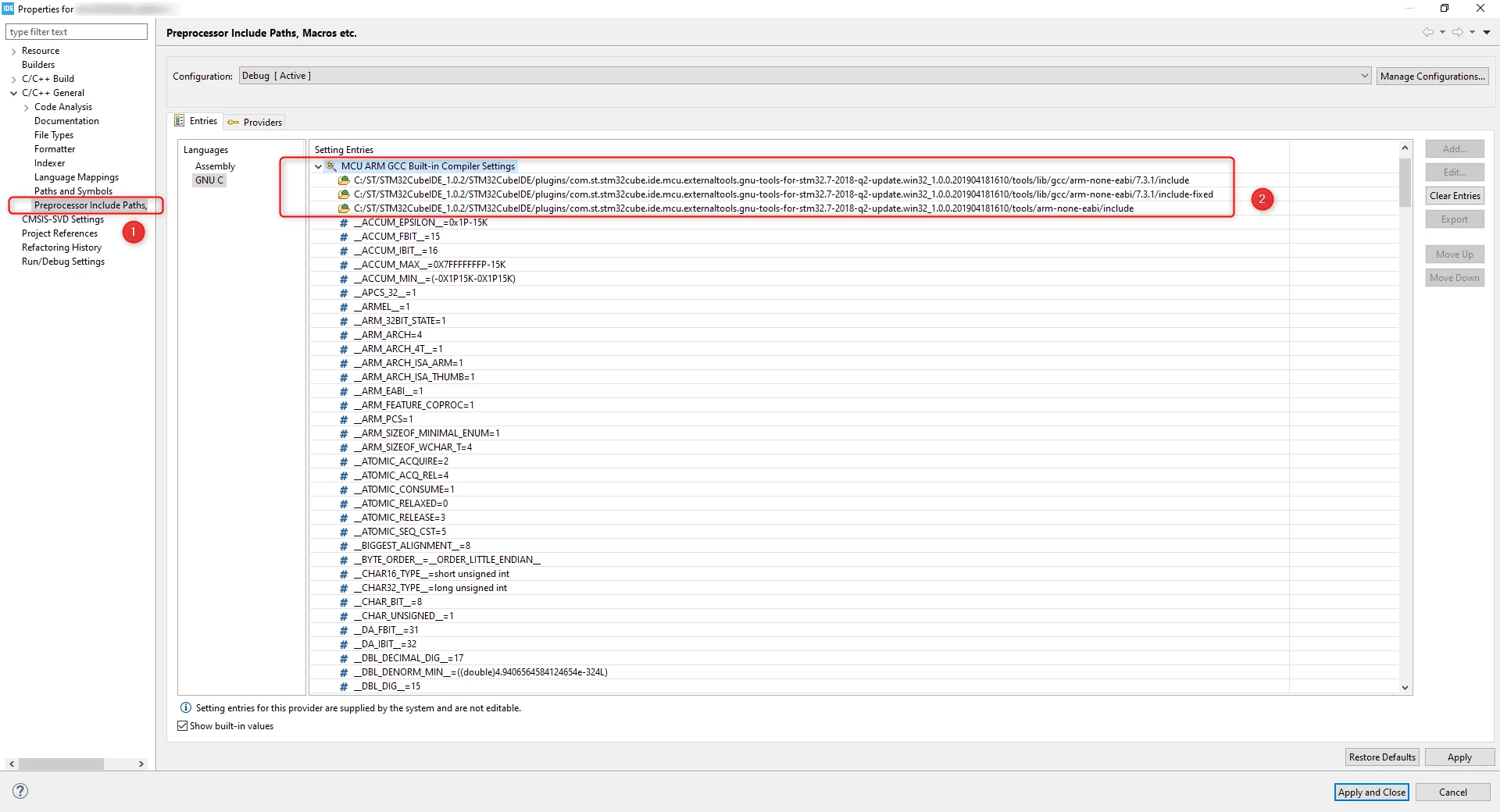

Thank you, but these settings are not editable.
I already replaced that directory with similar one from GCC 9.2 but it looks like a dirty hack and I still have no -std=gnu++17 option. I hope there is a legal way to install GCC 9.2 to have it selectable here:
