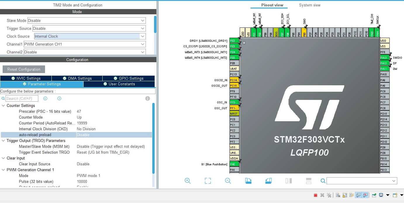

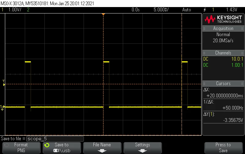

Thank you. I`ve set it up using 48MHz, Prescaler 47, Counter Period 19999 and Pulse 10000. I got a 50 Hz signal with period length 20000 µs.
Below are my code. I get a 1500 µs pulse (Initzialization signal) but i want a delay for 2 seconds and then give a 1700 µs to run the motor. This does not happen?

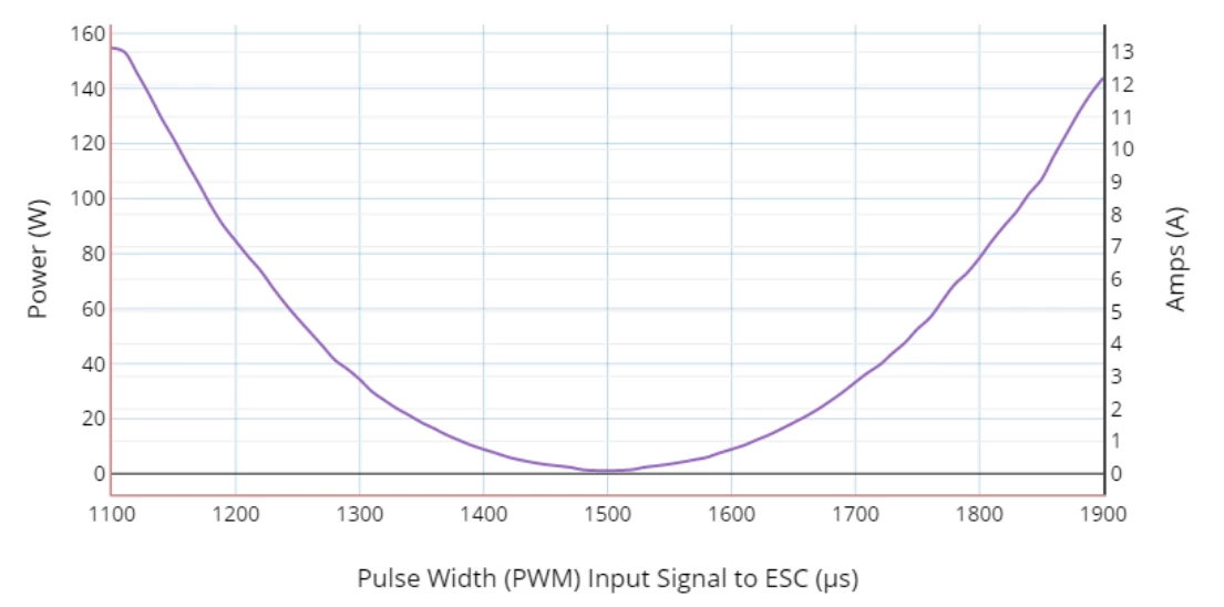

Attached are oscilloscope print and motor diagram if needed.0693W000007CW3YQAW.png0693W000007CW3TQAW.png

Scope isn't showing multiple seconds, diagram the waveform you actually want to see.

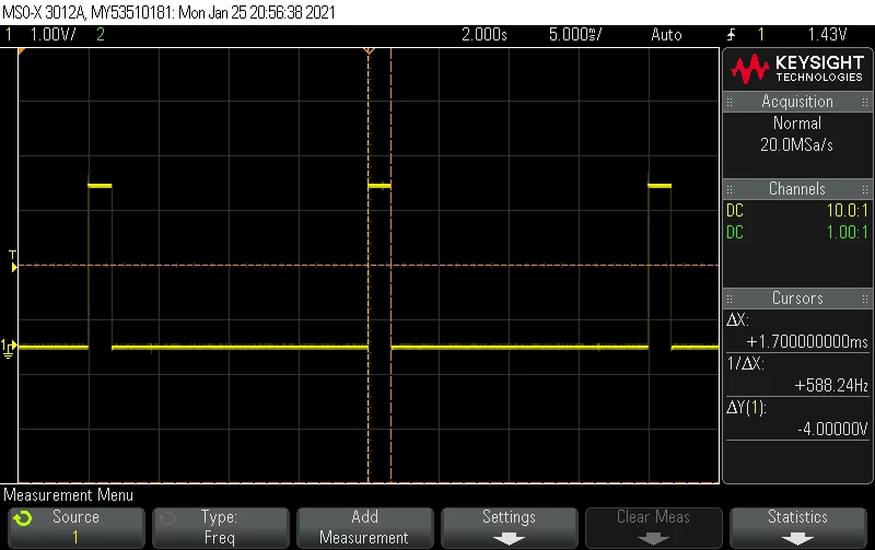

I tried to make a new prosject since i have change a lot of configurations during my troubleshooting.
Verifed the HAL_Delay on my oscilloscope, and now it changes to 1700 µs after 2 seconds!
Fantastic, but my motor wont run. If you guys cant fint anything wrong with my code i suspect the ESC to be defect..
Anyway thanks for your help
2 seconds delay 1700 µs0693W000007CWYMQA4.pngSTM32CubeIDE setup0693W000007CWYCQA4.png

ESC has typically a dead-zone around the neutral value (although your diagram doesn't show one). You could carefully try larger values or put the scope at the ESC output.
