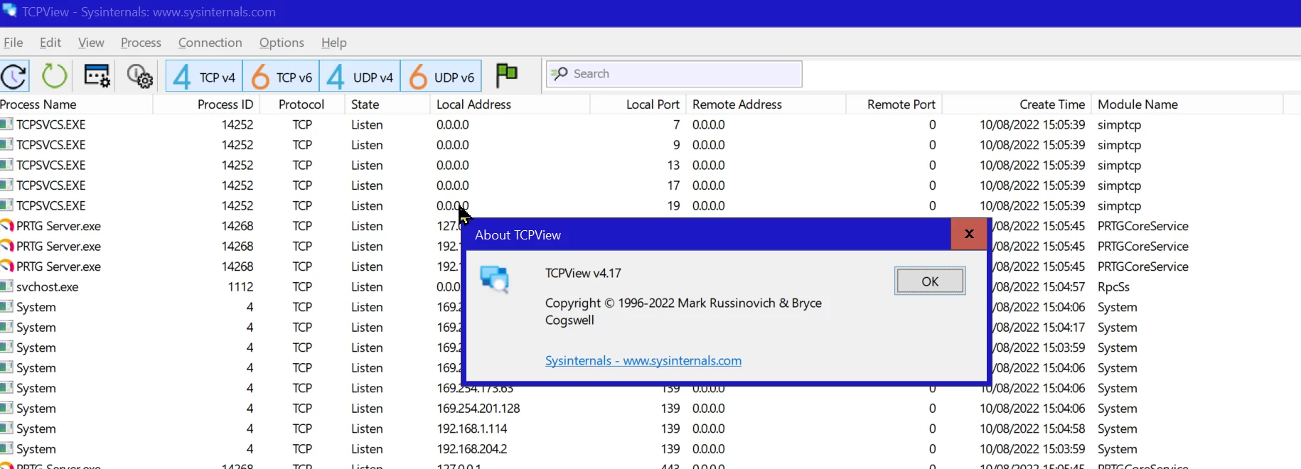

Like RRei.1 said you can use tcp view.
You can get it here, it's the new improved version better interface and yopu can filter for ports.
Regards
Rob
RRhei.1
Visitor II
Aug 14, 2022 3:24 AM UTC
Just use Sysinternals TCPView (or similar tool), find the port in the list and 'Close Connection'.
Try programming again.
