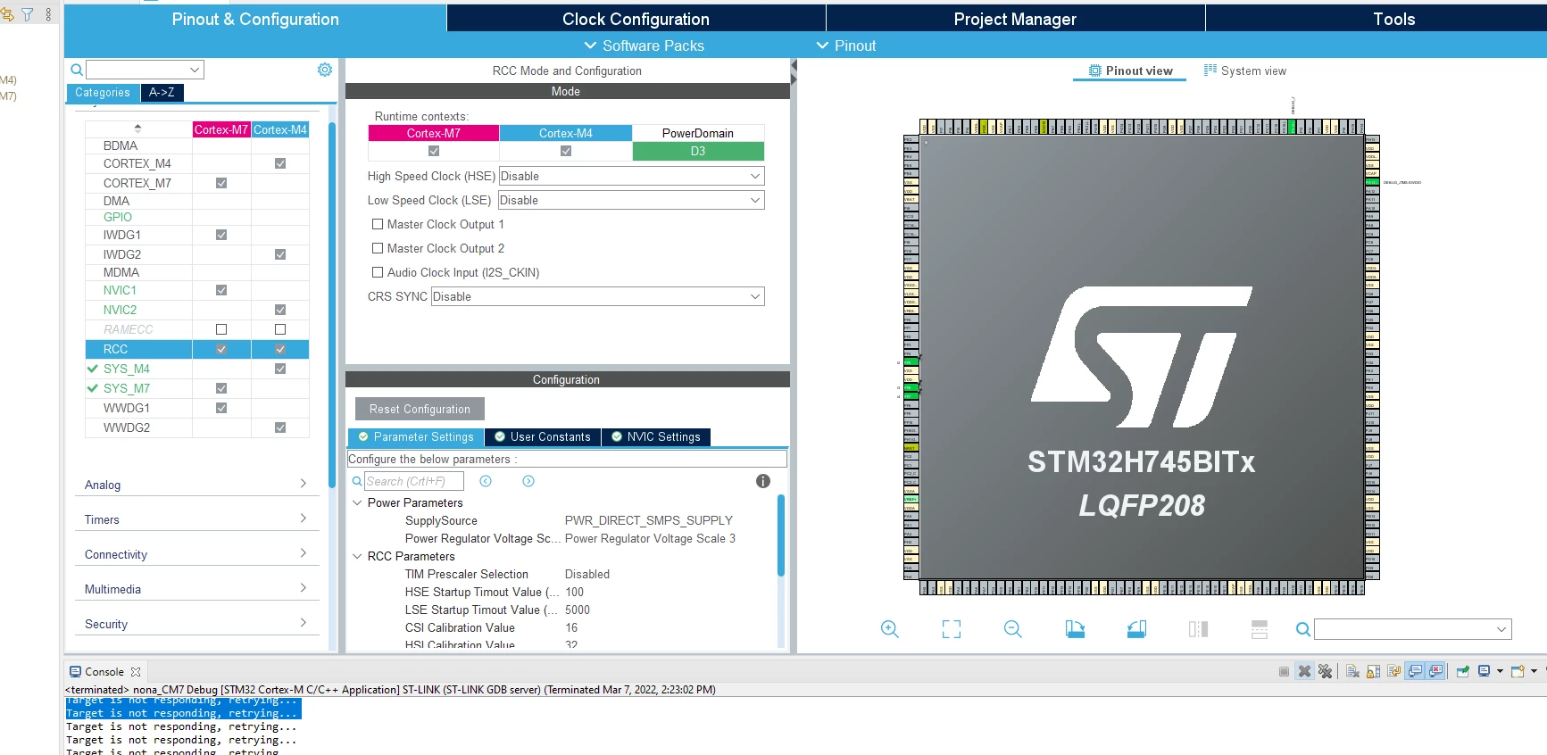

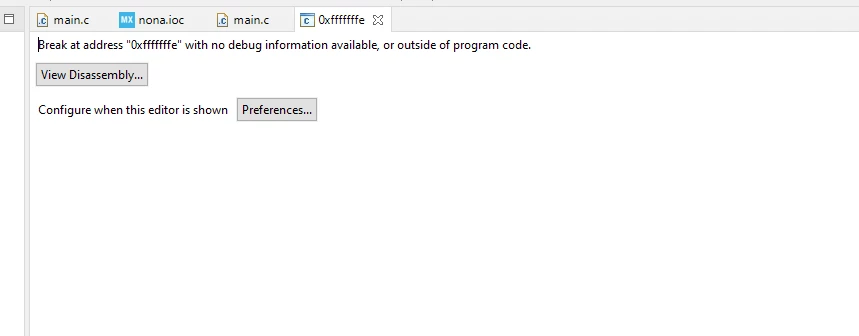

HI i am using a dual core STM32H745BIT6 and i am using an internal oscillator, i am having some issues
problem:
  1. this occurs when i launch the debugger "Break at address "0xfffffffe" with no debug information available, or outside of program code".

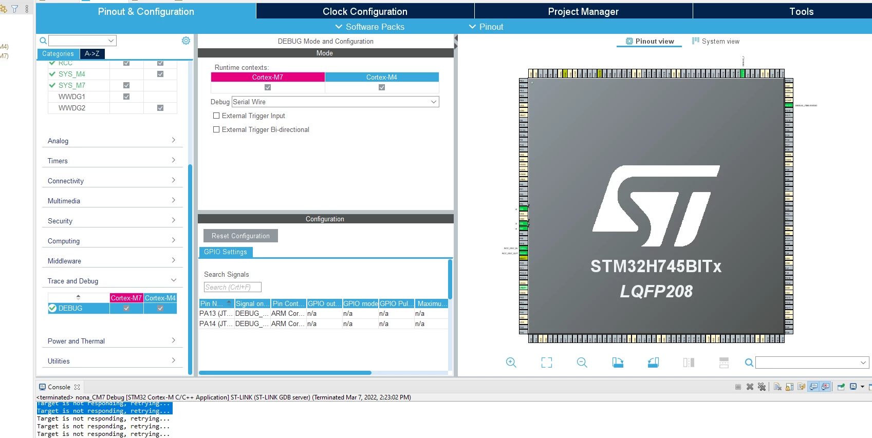

  2. when i click on resume debug then its like i disconnected the jtag it says "Target is not responding, retrying..." and then shutdown..... then says EXIT.
6 replies

Suggests it is reading 0xFFFFFFFF from one of the vector tables, as you've written FLASH section for one of the cores, and not the other.
Other tools merge the M4 .HEX into the M7 .HEX before writing the combined image.

In Keil the some project builds in two halves, you Build the M4, Download/Flash it
Built the M7 side, Download and Debug
Perhaps there are some video, tutorials or manuals for CubeIDE
Perhaps look at STM32H745I-DISCO board level examples. Project structure, meta-data settings, etc.

Have a look at this app note on how to setup a project for STM32H7 dual-core debug:
https://www.st.com/resource/en/application_note/an5361-getting-started-with-projects-based-on-dualcore-stm32h7-microcontrollers-in-stm32cubeide-stmicroelectronics.pdf
I think this is a good first step, it covers also how to load both elf-files in one debug configuration.
Then, let's see if your own configuration in MX actually impacts the behavior.
