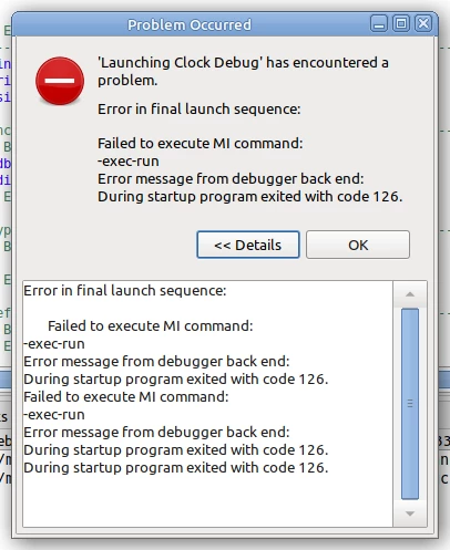

Hi, How to use/connect STM32CubeIDE with Nucleo144-H7 board? I've installed STM32CubeIDE, STM32CubeMX, STM32CobeProgrammer and STLink (Server) under Ubuntu Linux. I get an error when I try to download and debug (see attachment)! Can anybody help me?

Markus GIRDLAND
Jan 27, 2021 10:56 AM UTC
Is this for any project you create or for this specific one?
Can you connect to the board if you're using the stand-alone CubeProgrammer? Available here.

Hello Markus,
I've already solved this problem. I missed a right manual, I could not find it at the STM site, but I found it anywhere in the internet few days ago: I have to connect the board via "User USB" to program access/program the flash! Now it works.
Sometimes it is very useful to have access to and to read the manuals.
