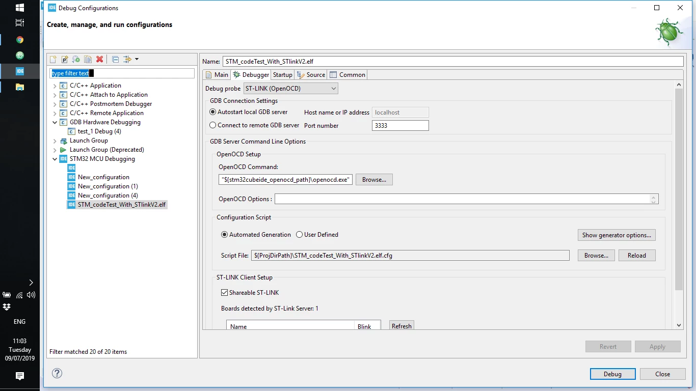

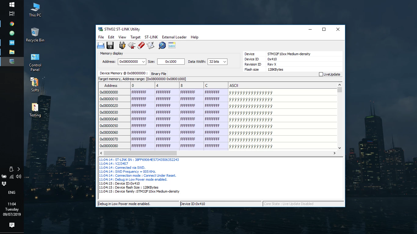

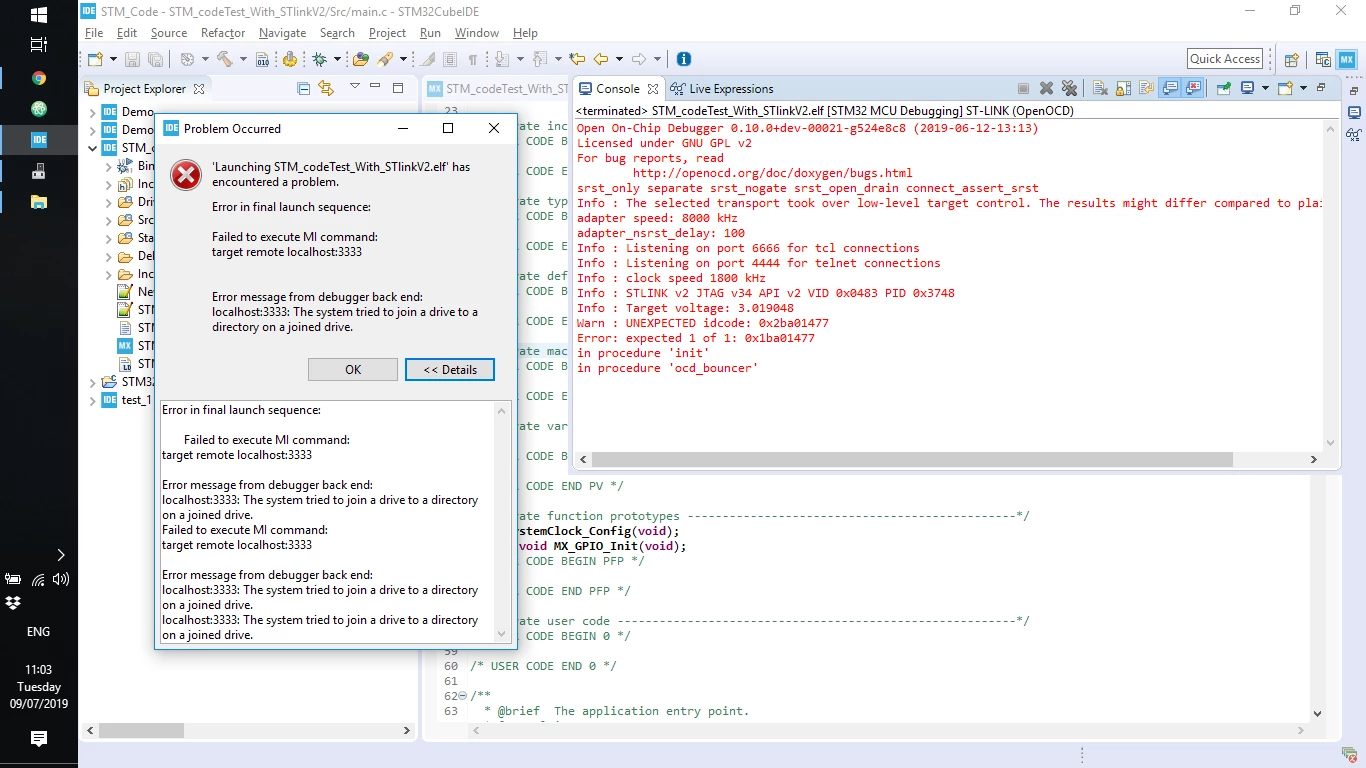

Hey newbie, using STM32F103RET6 chip and using STMCubeIDE and it's problematic for me. I have st-link V2 and using it in SWD Mode. But, I'm not able to upload code from STM32CubeIDE. But when I tried it with STM32 utility it gets connected.

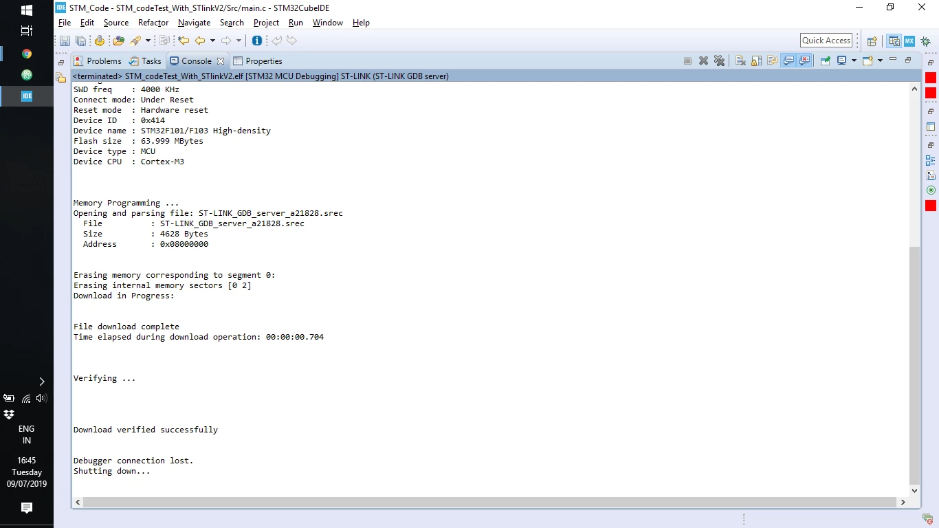

@Community member​  thanks for your reply, I got my problem solved. The problem was we have been using clone chip CSK one's but when I used another company st chips it worked in GDB server mode.0690X000009YZMBQA4.png
