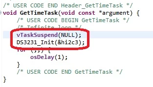

Hello! Who can explain how to make color highlighting for my own function from my library? Why my function is highlighted black?

Make sure it's linked properly and rebuild the project to make sure everything gets linked again.
If you're wondering more about general customization that can be done at Windows -> Preferences -> C/C++ -> Editor -> Syntax Coloring.

Thank You Markus!!!!!!
