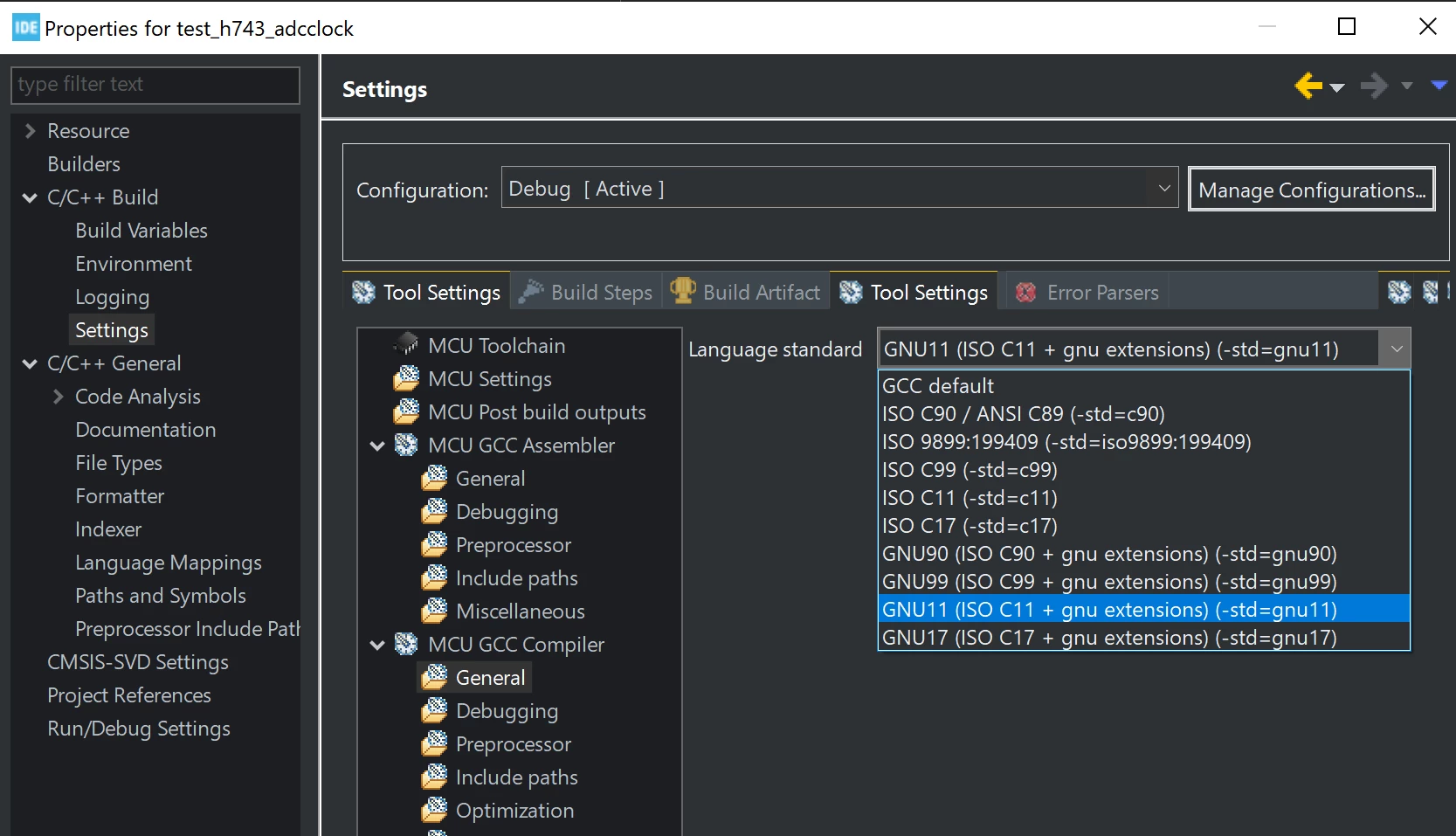

Hello- New to ST32 and the IDE, and re-learning C as well. I am trying to work an example using I2C for a 2 line by 16 digit LCD. When I compile (build) I get 4 errors, need to help if you would. 1st time poster....
error: 'for' loop initial declarations are only allowed in C99 or C11 mode
 223 |  for(uint8_t i=0; i<offset;i++)
 234 |  for(uint8_t i=0; i<offset;i++)
 250 |  for(uint8_t i=0; i<strlen(stringArray) && i<16; i++)
Error 1
"make -j8 all" terminated with exit code 2. Build might be incomplete.
I got it to compile yesterday with no errors, just didn't print to the LCD.
These errors happened when I deleted all and started over.
What am I missing?

For K&R C you'd need the uint8_t i; outside of the for statement and at the beginning of a compound block, ie immediately after the opening brace {
July 29, 2021
Go into your project properties and make sure you're compiling with C99 or later. Not sure why yours got changed.

Thanks TDK, that did the trick. Compiles fine.
