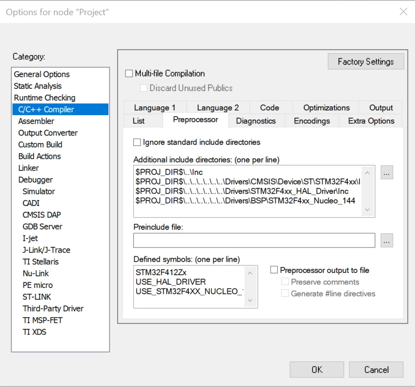

Hello, I am new to STM32, while making a empty project there is no stm32f4XX_hal_conf.h file created, so when i include stm32f4xx_hal.h and build my library it throws an error stating "fatal error: stm32f4xx_hal_conf.h" how to resolve this issue.

Hello @SMand.2​ ,
After generating a code based on STM32CubeMX, there is a necessary files must be included in STM32 projects so try to check the availability of thus files into your project.
Please check the path of your include directories :
0693W00000Y9M9xQAF.pngFoued

How are you making the empty project, in what?
There are template versions of the stm32f4xx_hal_conf.h that can be used, or copied from other projects.
