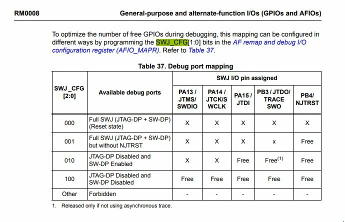

Hello. I am new to ST32F103C6T6 (and C8T6). I am using a Bluepill and STM32CUBEIDE to create my code. I'm having some problem to make PB3 to work as a GPIO correctly. I searched for a solution. Question: How to config SWJ_CFG using STM32CUBEIDE ???

Pinout & Configuration - Sys - Debug - Serial Wire.

Hello @MMORA.3​ ,
You can refer to the reference manual RM0008, in 'General-purpose and alternate-function I/Os (GPIOs and AFIOs)' and 'JTAG/SWD alternate function remapping' section.
PB3 is TDO/SWO, make sure to check how the JTAG-DP / SWD-DP mapping is set up on the STM32F1 parts, and check also DBGMCU_CR.
