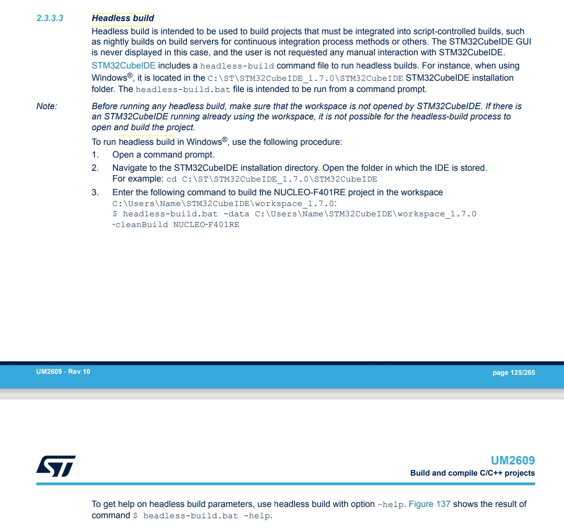

When is use those command to compile my project, some error occurred,
However,  When I use gui to build the same project, the result is ok.
command:
./stm32cubeidec.exe --launcher.suppressErrors -nosplash -data D:\Workspace\Firmware -application org.eclipse.cdt.managedbuilder.core.headlessbuild -build Taihu_FL/Debug
This is the log:

    Best answer by Nico4
    Thank you for your reply.
    Actually, I found that Once I set the "isbadioc=false" in ioc file, the problem will be solved.
    Otherwise, if set  "isbadioc=true", the problem will occur again.
    And the main problem is that line:
    "at com.st.stm32cube.common.logger.MCULoggerPlugin.openConfirmDialog(MCULoggerPlugin.java:292)"
    So I tried to compile the project in GUI,  Once I click build button, this confirm dialog will show. And it will prevent the non-GUI build proccess.
    2 replies
    Ghofrane GSOURI
    March 19, 2024
    Hello @Nico4
    Here are a few suggestions to address this error:
    1-Check workspace metadata: The error may be caused by corrupted workspace metadata. Try deleting the .metadata folder within your workspace directory. This folder contains various settings and configuration files for your workspace. Deleting it will reset the workspace settings, but keep in mind that you might lose some workspace-specific configurations.
    2- Try a new workspace: Create a new workspace and import your project into it. This can help isolate any workspace-specific issues that might be causing the error. To create a new workspace, use the -data option with a different directory path when running the command-line build.
    3- Clean and rebuild: Perform a clean build of your project to ensure a fresh build from scratch. Use the clean option before running the build command. This helps eliminate any potential conflicts or inconsistencies from previous builds.
    4-Check build configurations: Review your project's build configurations and ensure they are properly set up. Verify that the build configurations match the intended target and toolchain settings. Make sure all necessary paths, compiler options, and build settings are correctly configured.
    5- Try to follow those steps :
    I will be waiting for your feedback.
    THX
    Ghofrane
    Nico4AuthorBest answer
    March 20, 2024
