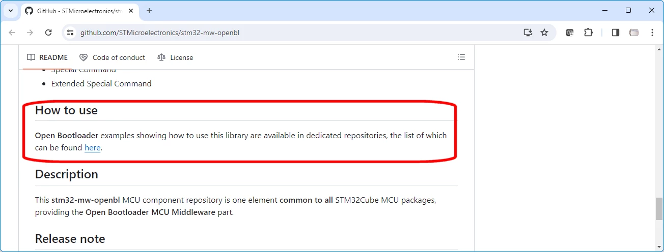

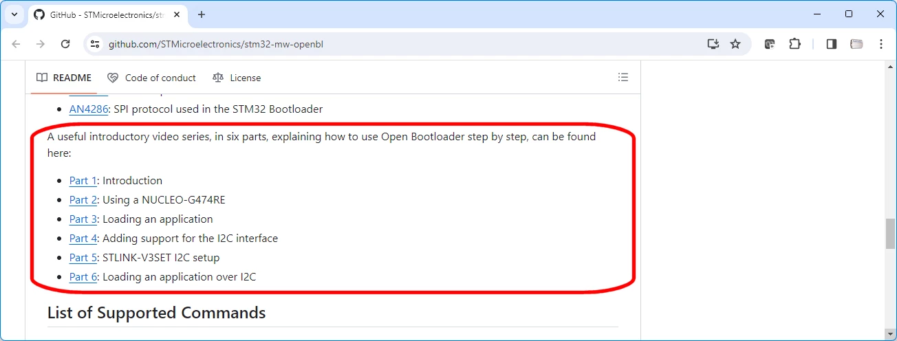

@Elmofty wrote:
i got it from https://github.com/STMicroelectronics/stm32-mw-openbl
So you saw this:
and this:

Did you read the "How to use" section?
Have you followed the videos ?
