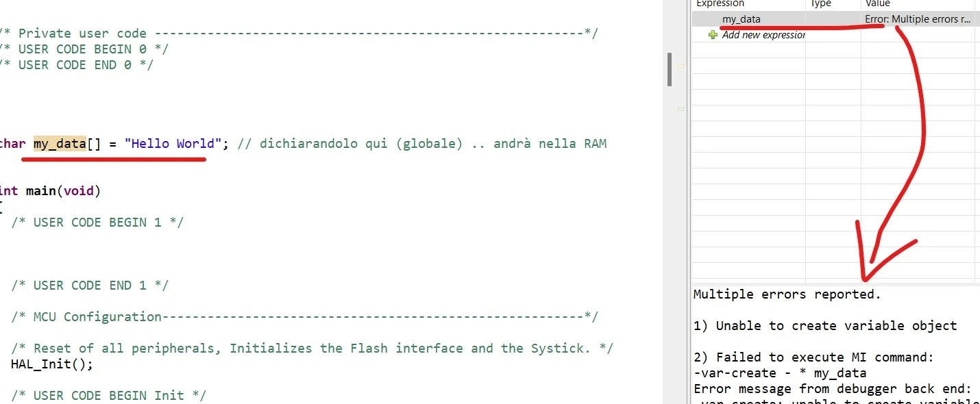

Has the Watch window been replaced with Live Expression??
I would like to see the value and position of my_data[].
I have always used the "Watch 1" section, but updating Cube IDE I can no longer find it.
Has it been replaced with the "expressions" or "live expression" section?
If the answer is yes, how come there is an error?
 EDIT: I managed to solve the problem by creating the project again and using the 'expression' section

Any clues in the tool release note?
luke514Author
Jan 14, 2023 6:29 PM UTC
