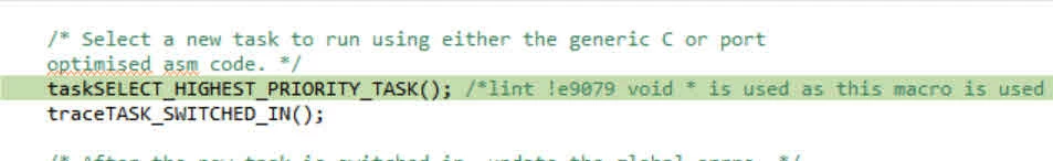

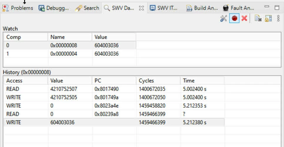

I took your advice and set up a couple of trace points at memory addresses 0x8 and 0x4.

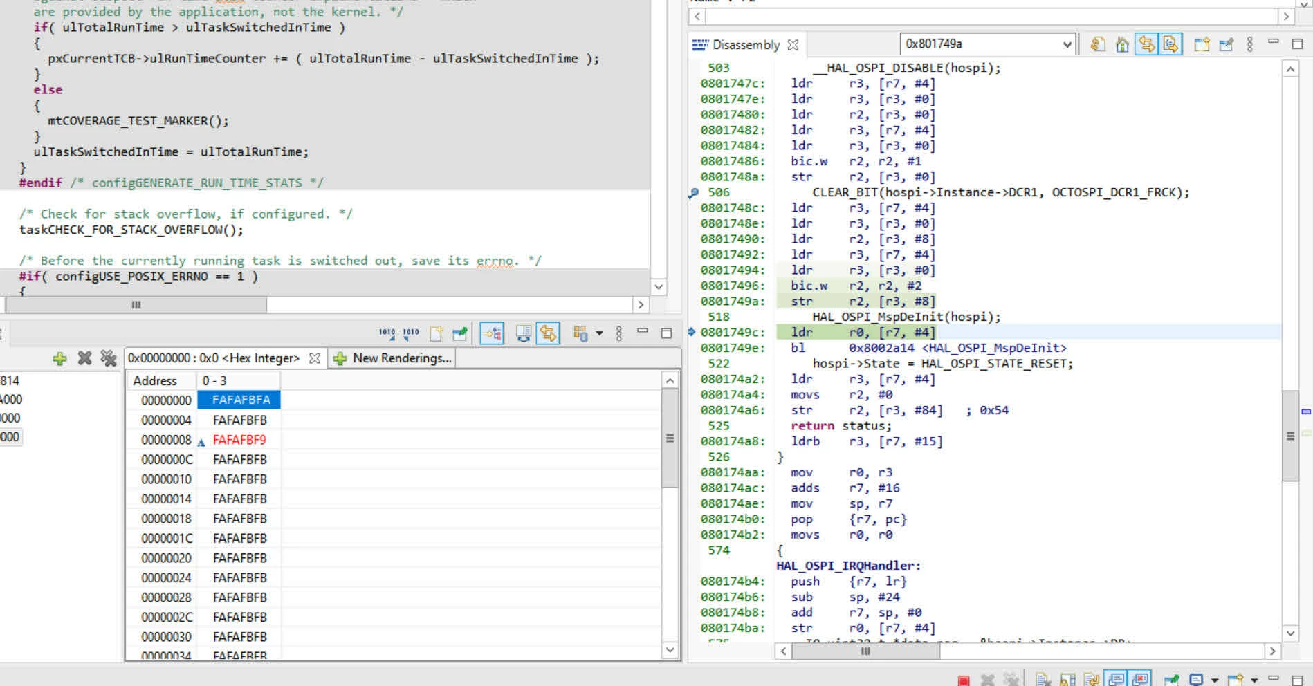

Instead of running the functions in ITCM I left them in flash and put a pattern of 0x40 words in the ITCM starting at zero. (0xFAFAFBFB)
I then ran without break points and found that there were writes being made to the ITCM ram.
The first write was made by the ospi deinit:
The second by freeRTOS vTaskSwitchContext function:

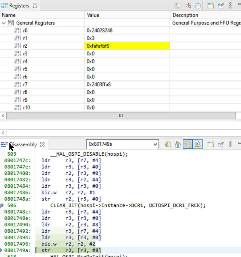

Looking at the disassembly first of these the, ospi de init we get:
You can see that the next instruction:
0801749a:  str    r2, [r3, #8]
will set the ITCM ram addr. to 0xFAFAFBF9
Which it does:
This looks a lot like a naughty stack problem. What do you think?
Th problem with this line of thinking is that the operating system scheduler isn't running when the ospi initialisation is running as this is executed at startup. So stack usage shouldn't be very high.
I will have a look at what the stack is doing.

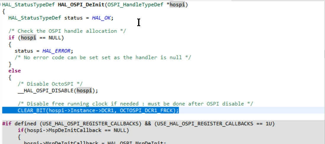

if (HAL_OSPI_DeInit(&hospi_nor[Instance]) != HAL_OK) this calls macro
CLEAR_BIT(hospi->Instance->DCR1, OCTOSPI_DCR1_FRCK); Line 17 below.
HAL_StatusTypeDef HAL_OSPI_DeInit(OSPI_HandleTypeDef *hospi)
 HAL_StatusTypeDef status = HAL_OK;
 /* Check the OSPI handle allocation */
 if (hospi == NULL)
 status = HAL_ERROR;
 /* No error code can be set set as the handler is null */
 else
 /* Disable OctoSPI */
 __HAL_OSPI_DISABLE(hospi);
 /* Disable free running clock if needed : must be done after OSPI disable */
as hospi_nor isn't initialized the clear bit macro accesses the ITCM address at offset #4.
